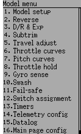

9. Model menu¶
The model menu allows selection, editing model configuration, alarms, logging and screen configurations. You can access the menu by pressing the ENT key to select the ‘Main menu’ and then again on ‘Model menu’.
Depending on the selection you have done for the Mixer GUI in section 9.1 Model setup (Std & Adv GUI), the model menu operation will be completely different.
The Advanced ‘2. Mixer’ page (9.2 Mixer (Adv GUI)) provides all of the functionality (and more) of the Standard Model.
| Advanced Model Menu | Standard Model Menu | ||
Note: The Advanced Mixer GUI is the default setting for all new models.

9.8. Standard GUI Menu items¶
The Standard GUI is an alternative interface from the Advanced GUI’. Which interface is used is chosen by the ‘Mixer GUI’ setting in section 9.1 Model setup (Std & Adv GUI). The Standard GUI is only available for Helicopter-type models at this time. The pages of the Standard GUI are as follows:
- Model setup: Model configuration page (See section 9.1 Model setup (Std & Adv GUI))
- Reverse: Servo reverse
- D/R & Exp: Dual-rates setup
- Subtrim: Servo sub-trim
- Travel adjust: Servo travel-adjust
- Throttle curves: Throttle curve setup
- Pitch curves: Pitch curve setup
- Throttle hold: Throttle-hold configuration
- Gyro sense: Gyro-sense configuration
- Swash: Swash Setup
- Fail safe: Fail-Safe configuration
- Switch assignment: Assign switch controls
- Timers: Timer configuration (See section 9.3 Timers (Std & Adv GUI))
- Telemetry config: Configure telemetry alarms (See section 9.4 Telemetry config (Std & Adv GUI))
- Datalog: Configure telemetry logging (See section 9.6 Datalog (Std & Adv GUI))
- Main page config: Configure main page display (See section 9.7 Main page config (Std & Adv GUI))
