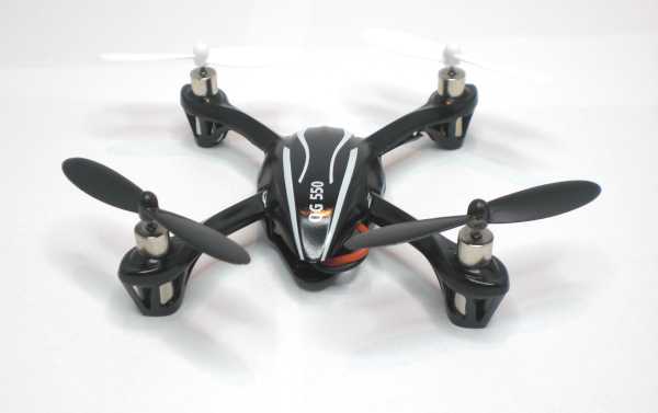

The Revell QG 550 works fine with Hubsan x4 config and ‘A7105-500m’ module.
