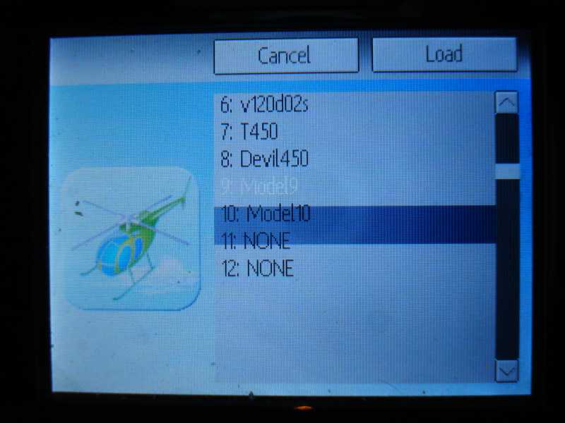

However I have been getting another issue, which is that when switching models, on any model above model 8, it will mess up the model list and highlighted area as pictured. It doesn't happen 100% of the time, only about 1 in 4 times of loading the model list. And it has to be on a model above 8. Protocol doesn't seem to matter. This also happened with original v2.0. But it doesn't seem to affect function, you can still pick whatever model you want. This is on devo 8s

Can you be more explicit about exactly how you replicate it? I can't seem to do so myself. are you using the buttons to navigate? is it only when you 1st enter the load screen or when you move the selection up or down?flint723 wrote: I can't get it to reboot with your fixed firmware.

No custom anything, just v2.0 clean installed (and now your updated version), then I moved my models in that I had previously backed up. It happens when I am on model 9 or any model above 8 and I click the model switch button using the touchscreen (not buttons), then cancel. It can be done very fast, ~2 times per second at least. So I am not switching models, just loading the model select page and then hitting cancel. Even if it is on a "None" model it will do it. I have tried it extensively on all models below 9 and it has never happened on 1-8.

I can reproduce this effect. If after that I scroll down, will appear the next numbers of the list (more than 12). If I scroll up, the list shortened down to 7 models.

The bug is triggered if the throttle was the last thing drawn before you enter the load page. So moving the throttle while entering the load page makes it easier to trigger. It also could be triggered in the emulator.
