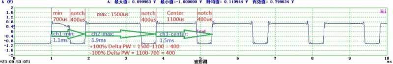

13 Dec 2012 02:12 #3966
by suvsuv
As different TX vendors use different setting for PPM output, e.g. Futaba's PPM settings are notch=300us and center+notch=1.5ms, there is no actual PPM standard. I might let the Frame pulse width be configurable between 20000 and 22500m
Replied by suvsuv on topic It's time for a 2.1 release?
Now PPM output can be tweaked for different PPM-FM module, below is test result to generate PPM complied with walkera's TXPhracturedBlue wrote: I implemented a config option in the code.
the default is set to match the devo10's normal output.
I also added support for more than 10 channels, though I'm notsure it will actually work.
Let me know if you have further issues. It works fine in Phoenix
