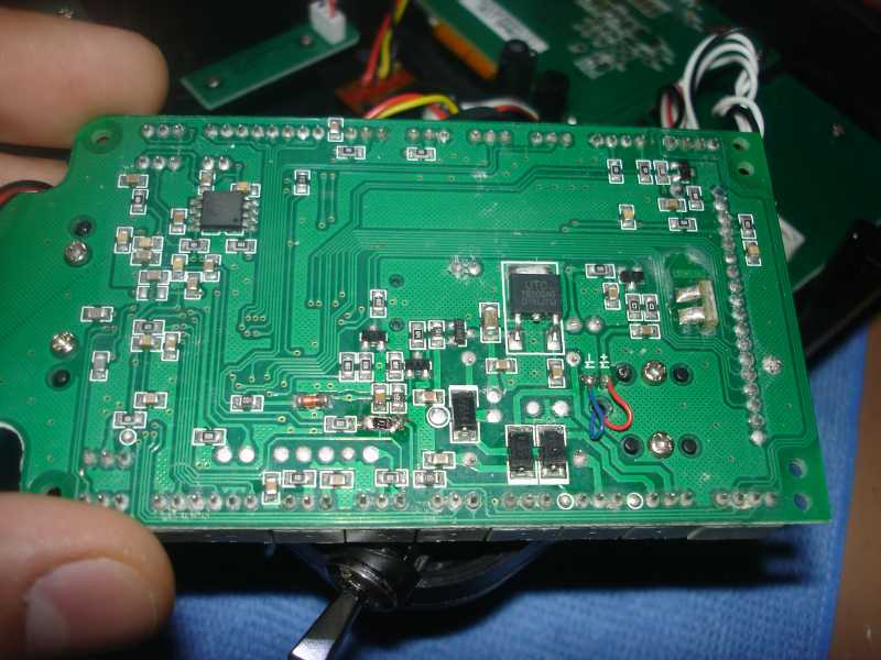

Hi PB
I don't think that the 5 cells will damage my Devo. The possibility to operate the Devo with 4 x 1, 5V standard cells can be found in the manual.
I agree with your statement about the wasted energy. I have installed a better voltage regulator in my 2801Pro which worked more efficiently than the original from Walkera.
I am considering whether it makes sense to equip the Devo also with a 3,3V voltage regulator and then return to 4-cells.
On my photo of the PCB I can see only the 7806 for recharging the batteries. Do you know where the linear regulator is located and whether it makes sense to change it with a high effective one?
10 Jul 2013 01:23 #12156
Replied by PhracturedBlue on topic Devo 8 battery
I agree you are unlikely to damage your Devo8 with the extra battery, I just don't think it will help much.
I never traced the circuitry, but the regulator is the RT9167a-33CB which is next to 2 electrolytic caps to the left of the MCU.
Note that the circuitry expects 5V for the voltage-monitor, and sends 5V to the CYRF6936 (which has its own LDO on board). The CYRF module draws comparable power to the Tx when at maximum output.
As far as damage goes, note that I have never seen the LDO on the Devo8 fail (from over-voltage or otherwise). I have seen the transistors used in the turn-on/turn-off fail for reasons that may or may-not be voltage related.

- sbstnp
- Posts: 649
21 Jul 2013 06:09 #12390
by sbstnp
Devo 10 + 4in1
Spektrum Dx9
FrSky Taranis + TBS Crossfire
Replied by sbstnp on topic Devo 8 battery
Just a bit offtopic but still related to this thread.
First, thank to RandMental, great work dude!
Second, it should be possible to increase battery life by replacing the linear regulator with a switching dc-dc regulator.
I have this on order for my Devo 10:
uk.farnell.com/jsp/search/productdetail.jsp?SKU=1696320
Inside my 10 there is this 78d05ag linear 5V output regulator that I intend to replace. From what I've read on the net it should double the battery life. I'm looking at ~95% efficiency at 12V input. That's massive compared to what's in currently.
Once I get the switching reg I'll create a separate thread and keep you posted.
