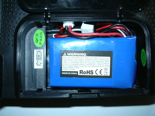

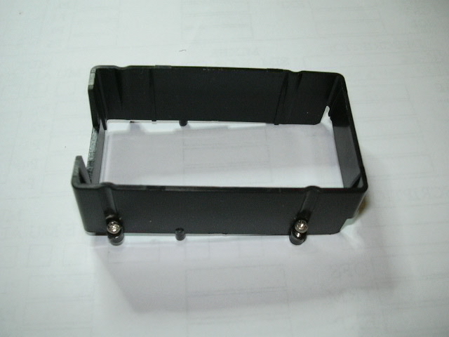

01 Aug 2014 15:39 #24949 by Birdman
Replied by Birdman on topic Devo 8 battery
This could be a waste of time and money as my Devo 8 looks like its headed for the tip.
Anyway, i need to connect a tx module which has a min voltage of 6v. So i need to run a 2s lipo. With diode voltage comes down to below 7.5v.
Will this be ok?
I found a 2100mAH rx pack lipo. If you unscrew and remove batt holder its fits just nice.
hobbyking.com.au/hobbyking/store/__22547...k_AU_Warehouse_.html
Bm

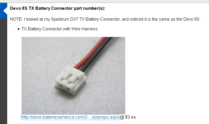

27 Feb 2017 00:14 #59662 by DSantapaola
Replied by DSantapaola on topic Devo 8 battery
Can sb tell me the correct name of the plug of the battery holder?
Thanks in advance!
27 Feb 2017 14:42 - 28 Feb 2017 17:44 #59682 by saidem
Replied by saidem on topic Devo 8 battery
It is a 2 pins 3mm JR connector.
Last edit: 28 Feb 2017 17:44 by saidem.
28 Feb 2017 12:54 - 02 Mar 2017 15:57 #59707 by DSantapaola
saidem wrote: it is a 2 pins 3mm JR connector.
Thank you very much.
Puhh...does sb know where I can buy this connector in Germany? Banggood and Hobbyking EU would be also ok, or some ebay seller. It's also used as battery plug in JR and Spektrum transmitters, but i can not find it anywhere.
Last edit: 02 Mar 2017 15:57 by DSantapaola.
06 Mar 2017 20:20 - 07 Mar 2017 16:18 #59926 by saidem
www.rc-connectors.com/index.php?main_pag...h=99&products_id=285
It seems to me that this connector is hard to find. I have seen here, but the shipping costs are very expensive and I do not know this website.
Try this:
fr.aliexpress.com/wholesale?initiative_i...s&needQuery=n&page=3
or do send a mail to wlakera parts, hobbygaga, hobbyone, ehirobo...
Otherwise it will be necessary to replace the connector by a JST connector like Devo 7E. I think you should find the picture in the forum.
Try this:
store.batteriesamerica.com/2-pinflatwhitetxconnforjrpropo.aspx
www.ebay.com.au/itm/2-JR-SPEKTRUM-TRANSM...81895147980#shpCntId
Perhaps contact a spektrum resaler in your country!
