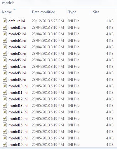

28 Feb 2014 20:35 #20993 by stevecox
Replied by stevecox on topic DEVIATION 8s, Lost all models below 8
The actual file name itself is critical see attached for the exact file name format and yours should be named exactly like this, with the exact extension .ini and also watch the line endings in your text editor are set correctly if you edit the files ...
Could you give a screenshot of your directory listing and maybe one or two if the ini files, typically model9.ini

28 Feb 2014 21:07 - 28 Feb 2014 21:27 #20998 by linux-user
Replied by linux-user on topic DEVIATION 8s, Lost all models below 8
glpdrum wrote: Corrupted file is a supposition.
I put 9 back, looked at all the files in the drive on the pc, safely removed the drive and It still showed only up to 8. Tried one more time making no changes to any files/models, safely removed the drive and the radio shows 1 model now. If I take a new unused models folder they all show up on both pc and radio. If I try to add a model (from a new source i.e. just downloaded) it will not load. If I try and paste a model into a model # it will drop between them, not take their place.
Ahh, that was helpful.
Now I think I know what you are doing wrong.
Watch the picture from stevecox!
Your models should be named exactly like in the picture.
You can click with the right mouse-botton on a model and rename it to match the naming.
And it may be helpful to display the file extensions
windows.microsoft.com/en-us/windows/show...nsions=windows-vista
Last edit: 28 Feb 2014 21:27 by linux-user.

28 Feb 2014 22:02 - 28 Feb 2014 22:30 #21001 by linux-user
Hmm,
I hope it is not necessary to format the drive.
1.) When you copy the models folder from your fresh deviation download to your TX, then everything is as expected. right?
When you switch your TX to normal operation you see:
1: Model1
2: Model2
9: Model9
10: Model10
2.) now you can pick one of TomZ's models and rename it i.e. "model9.ini"
Do this on your PC, not on the TX. (best before connecting TX to PC) OK?
3.) copy this "model9.ini" to your TX.
now from the view of the PC your models folder should look the same as before (like the picture above from stevecox). right?
4.) you switch your TX to normal operation.
now you should see the new model in your Devo8s
something like
1: Model1
2: Model2
9:MasterCP2
10: Model10
Last edit: 28 Feb 2014 22:30 by linux-user.
