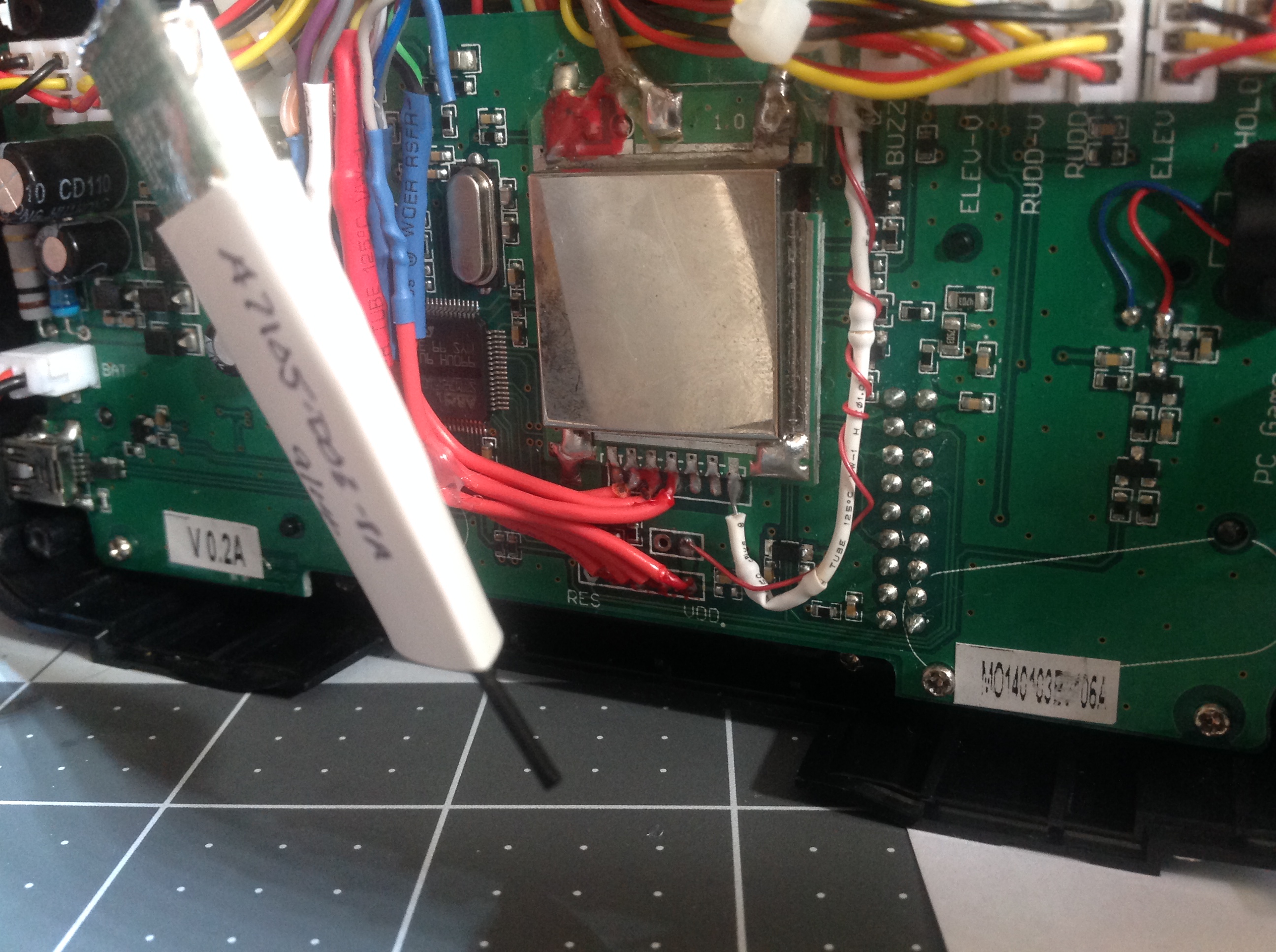

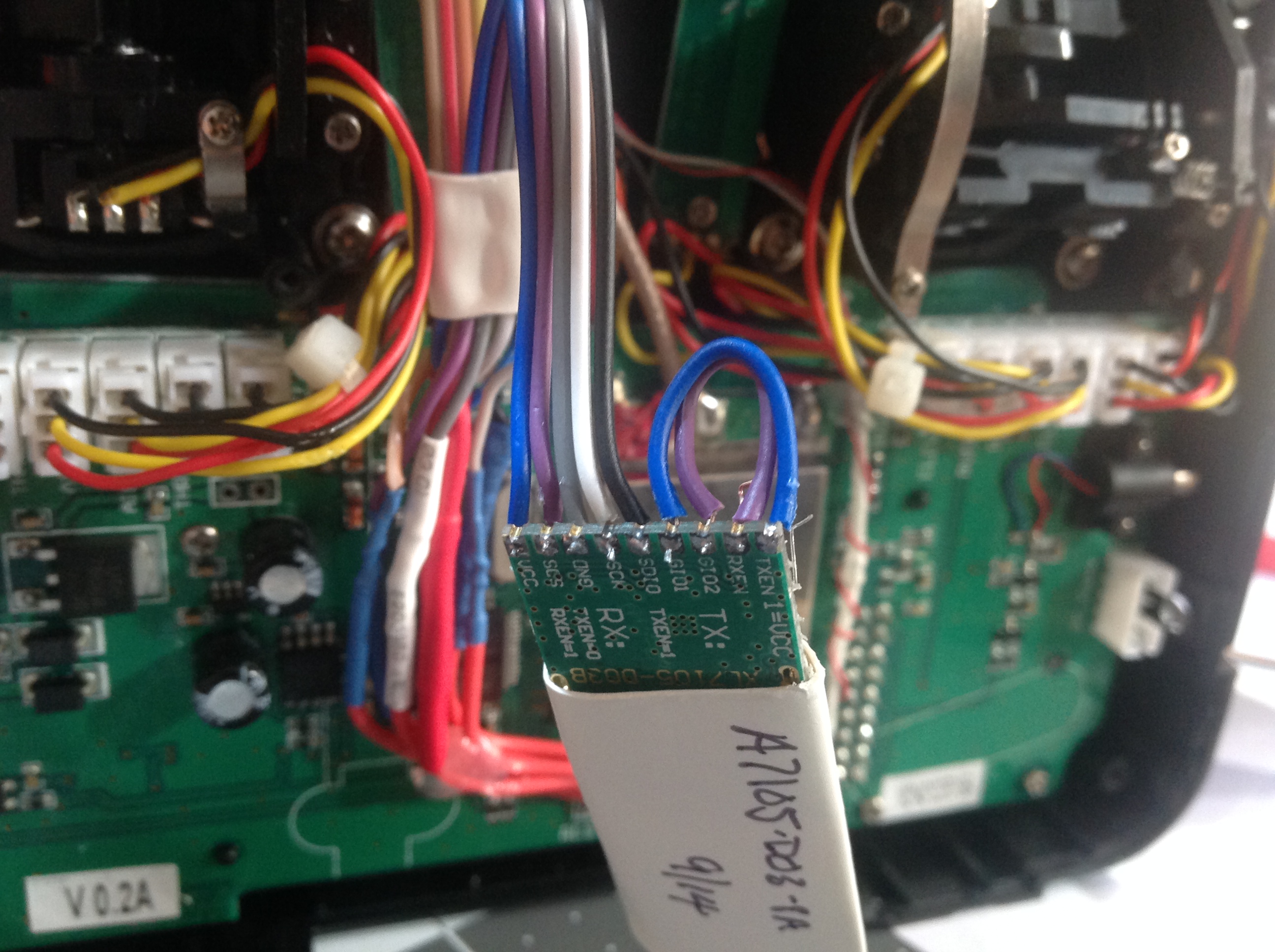

Is there a way to tell if the A7105-D03-PA is defective, other than just getting a failure on power-up or when we try to use a supported protocol?
I replaced my A7105 and it worked for about a week, then once, upon power-on it gave me the "Missing Modules: MultiMod" error. I quickly powered off and powered it back on, and that error didn't reappear... well for about another week, during which I spent a good deal of time flying using that radio. I have an NRF module installed too, and it is working perfectly. If I power on with a protocol on the NRF or CYRF modules things work as normal.
Now I get the "Missing Modules: MultiMod" error any time I power on with one of the A7105 protocols selected. I also have the "*" in front of the protocol names; it's pretty clear the module isn't working. I have checked the wiring for breaks or problems on the 7e board; when I installed the boards I wanted to be sure that if there was an issue I could avoid soldering on the 7e board, so I soldered just one wire to the 7e board, and the wiring from each module is joined to the appropriate connection (I've spent most of my career in network systems, so I'm pretty good at spotting wiring issues). On the A7105 module I have voltage at Vcc (3.23v), and SCS (3.23v). I also checked GIO1, GIO2, RXEN and TXEN and found 3.23v on each of them.
This is my hardware.ini:

If I put the semi-colon in front of the A7105 lines, the error doesn't show up, but of course the protocols are not available.
For the photo I have removed the heat shrink tube that I put around the module, along with a bit of hot glue to keep the wires immobilized.
Any ideas? Thanks!

01 Oct 2014 00:43 - 01 Oct 2014 00:44 #25895 by aMax
Replied by aMax on topic a A7105 module defective?
Deal57 wrote: ............. I can put off the MM but I was looking forward to more hardware fun, which was long ago a big part of my work.
Oh dear, looking a second time at your pictures, I noticed a wire at RES. But your hardware.ini does not give a hint for an aktive MM.
Did you solder the modules to a MM? At that point i would be out, having no experience with this mod.
Last edit: 01 Oct 2014 00:44 by aMax.
01 Oct 2014 11:17 #25899 by Deal57
Replied by Deal57 on topic a A7105 module defective?
I looked again and the photo is misleading and no, I don't have the MM.
I have soldered my leads to the tms, tck, gnd and vcc connections on the board, and the 2,3 and 4 pins on the CYRF. TMS (A13) is connected to my NRF24L01 module, along with the other appropriate lines. TCK (A14) is connected to the A7105. I hope to check the current consumption today.
