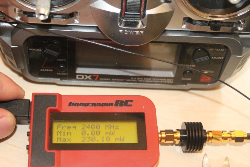

Please Seyby, would you please take your ImmersionRC RF Power Meter and do this with your Devo 10 and on the 7e for the NRF?

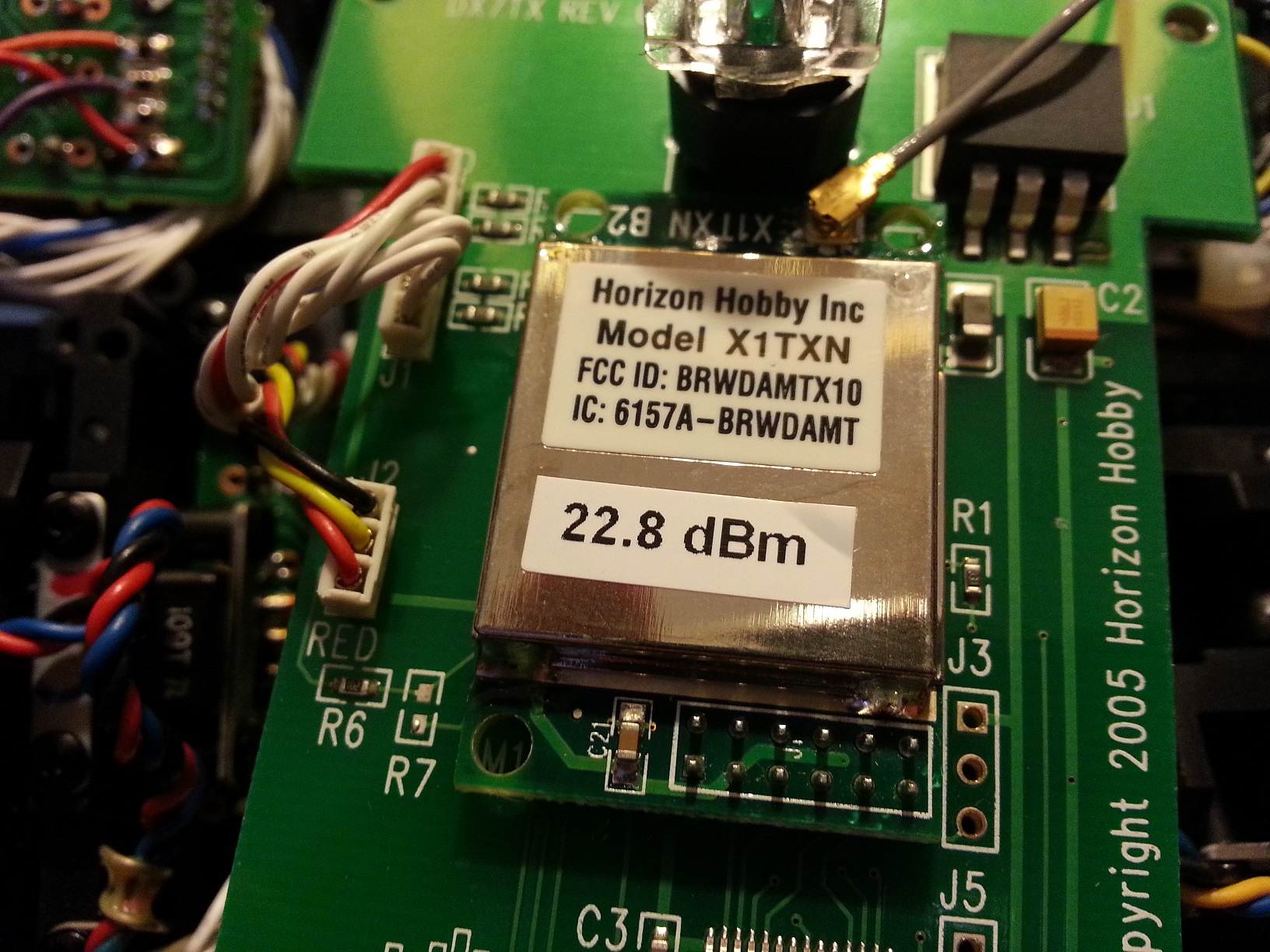

.... 65mW is not bad at all considering the FrSky DHT (DJT&DFT) modules you can buy for different TX, are even 60mW.
But we should stop comparing the Devo with the Spektrum TX, especially the US version, as they can have up to 230mW.

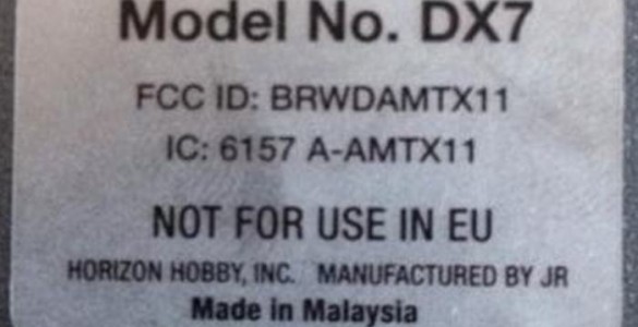

I have an old Spektrum DX7 bought some years ago imported from a small Hobby shop in the States.
In theory, my DX7 is a USA version, but the FCC ID is not the latest with 300mw power output.
Anyone could explain me what's the power output from my DX7?

Strange power output. Not the USA version power output (300mw) but not EU version (about 100mw)
I guess this radio probably was version 1 or something similar

I believe my Spektrum DX8 had ~18.x dBm (below <20dbm) written on the HF module label when I had opened it.

Replied by RoGuE_StreaK on topic Deviation output power 150mW = 100mW
Interesting; the RF summary says the 6, with a 0dbi antenna, has a peak power of 14.5dbm, while with 3dbi antennas the 8s and 10 give 18.2 and 19.31 respectively.FDR wrote: You can find the measurements for all DEVO transmitters if you search for the Walkera grantee code, wich is S29
www.fcc.gov/general/fcc-id-search-page
No idea what that translates to, but seems to show a good case for swapping in a gained antenna if you are using a 6/6s.
Though also of interest is in the internal photos, which unsolder the shield of the modules, both the 8s and 10 are shown with black modules? And it seems from a brief comparison that the module shown for the 6 has three additional capacitors, which are left onpopulated on the ones shown for the 10 and 8s?
