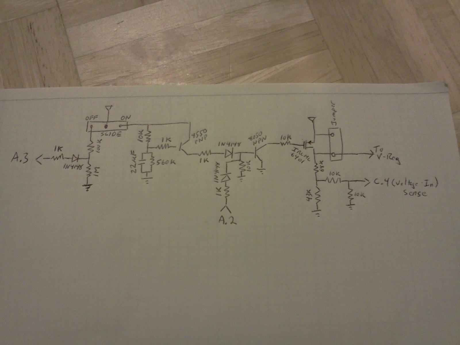

24 Jan 2016 23:06 - 25 Jan 2016 03:57 #42181
Replied by hexfet on topic CC2500 power issue (formerly 'I need a Rx...')
No schematic that I know if, just a little
hardware info.
. PB posted previously that he determined the voltage transfer equations by measurement.
Not sure where I got the attached diagram of the devo10 power input circuit, but it does not correspond to the measurements (the voltage divider doesn't match up).If the part about the FET switch is correct, there will be some voltage drop there that varies with current that will affect the measurement. Would be interesting to know the voltage drop there at various loads. After looking up the FET there shouldn't be any appreciable voltage drop there if the drive circuitry is working correctly.
Checking the ADC readings on my devo 10 with known voltages gives a constant about 6% different than what's in the code, which is about the difference between the screen and my battery. I think there was also a post about possibly making the constant adjustable by config file so people could compensate for differences in their own radios. More complicated would be a calibration step.
I'm not sure the current equation is the best. Seems to me if finding the constant by measurement then the curve fit should force the intercept to zero (the VOLTAGE_OFFSET should always be 0) since 0V into the ADC will give a count of 0.

Possibly a 10uF at C4, could help smooth out this fluctuation effect when using Frsky protocol, any one know Volt measurement point for devo 7e ?
Indeed the real voltage in my devo 7e and displayed oltage are also off, by 0.1 Volt
- Fernandez
- Posts: 983
06 Feb 2016 20:21 #42688
by Fernandez
Replied by Fernandez on topic CC2500 power issue (formerly 'I need a Rx...')
I connected a 10uF capacitor to the ADC pin of voltage sense line.
I coould see the Capacitor was working as when switching on Tx, it start directly with a vbat low alarm, then voltage level displayed now rises slowly (charging of the capcitor)and it takes several seconds to display up to full pack voltage.
But surprisingly the fluctuation on voltage displayed on the 7e remains the same.
Even with the capacitor still the voltage ws fluctuating excactely same manner......
