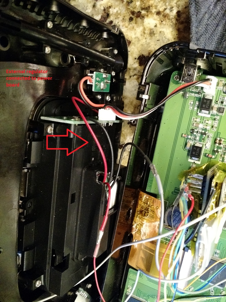

I also have a 12s that has the noise problems, it only happens when using any of the frsky protocols. The combined draw on the voltage regulator pushes it to the limits and creates noise on the power lines. (I have not verified this with an oscilloscope as I don't have one available to me at this time) I am using two small power supplies, LM2596s, to power the multimod seperately and the main board from a 3s battery. The noise on the analog channels is significantly decreased, there are no visible fluctuations on the input test screen. That being said, there are minor deviations on the signals that are showing up in cleanflight. The changes are 1 point changes. IE 1099 - 1100 or 1501 - 1502. That is very small compared to the 4 - 6 point change when I started this process.
Hope this helps. If needed I can send pictures later.

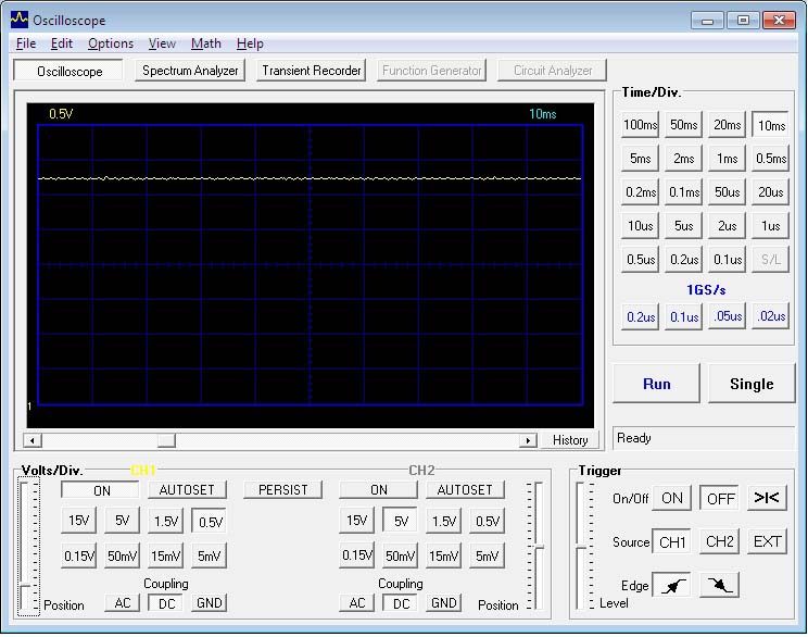

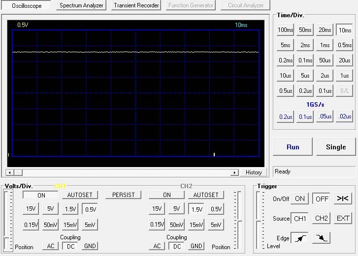

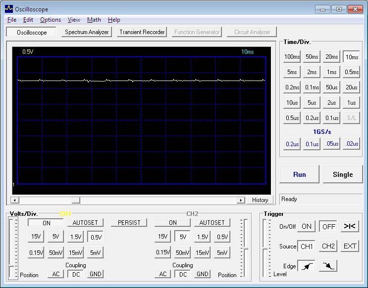

I have tested with my old oscilloscop.
Look at the pictures(without any modification)
then i`ve tried with Elko up to 1000uF.
This would ca half the ripple.
Then i tried this in combination with Diode N4001 to VCC A7105 and CC2500.
Capacitor on TX(Prozessor Side) not that much better...
Hmmm....
Any electronic expert out there, who can tell me what to try?
Flysky with A7105
FrskyX with CC2500
DsmX with Cyrf6936
and last... no module active (Throttle not at min)

- 944storm
- Posts: 55
06 Apr 2016 01:40 #45886
by 944storm
Replied by 944storm on topic noisy and fluctuating analog Inputs and TX Voltage
@wene001 what type of oscilloscope are you using? Would like to get one and the software and readings look good!
A super cap is used to store larger amounts of energy than a normal electrolyte cap. That's it in a nutshell. They take longer to charge but hold the charge for longer periods depending on the drain on them.

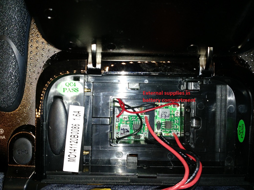

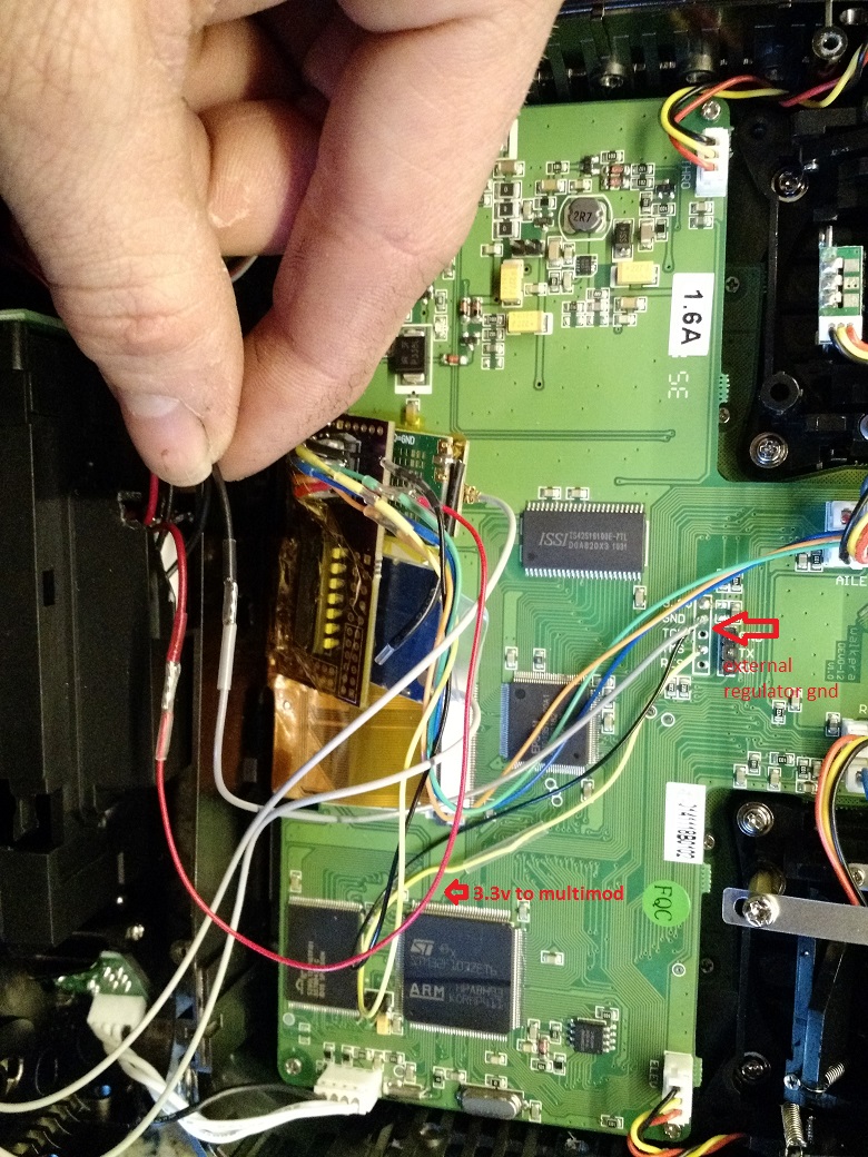

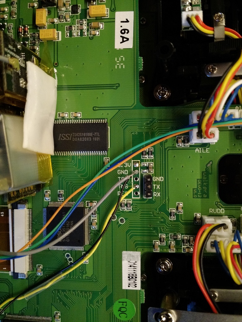

- 944storm
- Posts: 55
06 Apr 2016 23:53 #45982
by 944storm
- Wene001
- Posts: 277
07 Apr 2016 13:18 - 07 Apr 2016 13:18 #46027
by Wene001
Replied by Wene001 on topic noisy and fluctuating analog Inputs and TX Voltage
Thanks for the pics
i Would like to stay with the 1S Battery.
Do you think there is no chance to filter the noise from the intern 3,3V VCC?

Current peaks are in about 9mS
i tried to power the modules direkt from the 1S Battery in my Devo 12s ( Diode in series to reduce the voltage)
In this case all is perfekt. so i think its no rf leakage. But this is no Option, because in this case the modul is not powered off with the Transmitter.
i ve tested with my extern linear Power Supply too, and have seen pulsating power consumtion from cc2500. (about 80 mA)
Now the big question for me is, how to get the intern 3.3V stable??
Midelic sent two links about LC Filters in the FrskyX Thread
i tried to build such LC Filter with Elektrolyt (1200uF) + Ceramic Capacitor plus a diode and coil in series with not much success
i have no knowledge about coils so is testet a handful i had laying around.
Any help is welcome.
Last edit: 07 Apr 2016 19:24 by Wene001.
- midelic
- Posts: 174
07 Apr 2016 19:30 #46059
by midelic
Replied by midelic on topic noisy and fluctuating analog Inputs and TX Voltage
First calculate the pulse period and frequency of that pulse...and there is LC calculator on the net.
Imo but and exiting LC filter from the net ,buy also coild with inductanve closesest value to the one calculated and change the capacitor and coils
circuitcalculator.com/lcfilter.htm
