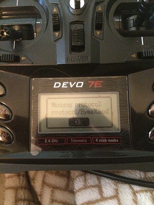

ok i removed the semi colons and changed to a-13
now when i try to bind the syma x5 its saying
Missing Protocol
protocol/symax.mod
what does this mean??
Missing Protocol
protocol/symax.mod

shen13 wrote: ok i removed the semi colons and changed to a-13
Missing Protocol
protocol/symax.mod

24 Apr 2016 17:19 #47108
by Arakon
Replied by Arakon on topic lost program devo 7e
It means you didn't copy all the files to the transmitter.
After flashing the DFU file, you need to copy ALL folders and all files except for debug-devo7e-xxxxxxxx.zip, deviation-devo7e-xxxxx.dfu and UPDATING.md.

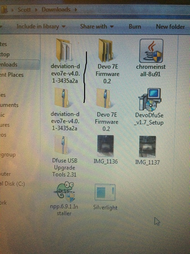

- shen13
- Posts: 28
24 Apr 2016 20:05 #47114
by shen13
when you download the file then unzip does it supposed to have 2 folders (the same)
Replied by shen13 on topic lost program devo 7e
shen13 wrote: ok heres what i have done now..installed the 3435a2a defuse now...
now its giving the ,missing modules cyrf 6936?i run defuse then i went to usb and reformatted(which deleted ll the files)
then i copied all; the files except defuse and debug to usb now i get above message

Can you show the contents of the transmitter folder instead?
