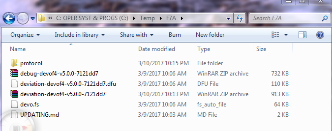

I believe the file system library is missing. The deviation file system library for the F series controllers is entirely contained in a file named,"devo.fs" which belongs in the root directory of the controller of the F series.
For you, I think the simplest fix is to completely reinstall the firmware using the DeviationUpload Tool 0.8.0.jar and the .zip file of the firmware for your controller. Do not unzip the firmware .zip file. Use it as is without unzipping it. The Upload Tool recognizes the .zip file and will take care of unpacking and putting everything in the appropriate location on the controller. Basically, it just installs the firmware and the devo.fs file - that's it. After doing that, you should be good to go when you restart the controller.
After that, if you want to add models or protocols or change anything about the file system, you need to create and install a revised version of the devo.fs file - but that's an issue for another post... ;)

I had this same problem when I first installed deviation on my Devo F4. The reason for me was that the devo.fs file was not installed. After I put the devo.fs file on the F4, all was well. Possibly, the devo.fs file on your F7 is corrupt & won't work. I'm pretty sure the devo.fs file is your problem.

Ok, so, that devo.fs file may be ok for a Devo 7E, but not for a Devo F7. Reinstall everything again after you have the correct controller recognized. Also, double-triple check that you have the correct firmware .zip file for the F7.

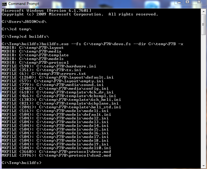

I am wondering if the issue is dsm2 or the receiver and would like to add dsmx to see but I cant get buildfs to do it. It keeps say access denied after the commands are entered. I am admin and using cmd as so but cant seem to get it. I am doing some test later today with the radio and other builds to see if I can determine if thebredcon is shit but still need dsmx on the f7.
Can someone help me out here or maybe if someone has a deviation 5.0.0 devo.fs with dsmx dsm2 and the walkera protocol fo the devo f7 that would help too.

I added the .fs file in the zip attached. It has DSMX DSM2 already enabled. This was working in my F7 prior to me doing the memory mod. Although working with .fs isn't very hard but you'll have to understand the command and remember your file system paths to correctly extract and build your .fs file.
