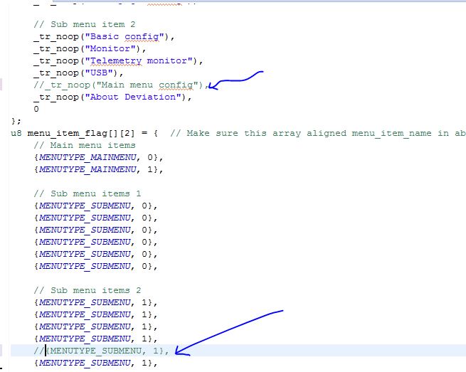

16 Nov 2012 15:21 - 16 Nov 2012 15:21 #2942 by suvsuv
PhracturedBlue wrote: none the less, I don't expect to take suvsuv's current changes as is. it will add a change to the model.ini which I'll just need to remove later, menaning less compatibility going forward. being able to switch between pages from the main-page is much more convenient, and will be usable by both devo8 and devo10, meaning the model configuration is portable. Then we can additionally be more intelligent (like not having access to telemetry pages when telemetry isn't supported by the protocol). At that time, I'll remove telemetry from the main menu.
If you don't want to see it, just comment out 2 lines in the menu.c. The change is not in model.ini but in tx.ini.
But I do see the benefit of the feature I got good feedback from devo10 users, the menu it devo10-specific and I don't agree that devo10 must be exactly the same as devo 8.
