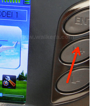

6) I would insist on swapping the R/L behavior in the real devo10, please don't make your judgment by playing with devo8 or emu_devo10. In the real devo10 device, the R key points to the left while the L key points to the right, please do test the keyboards in a real devo10

for (6) if you really want the right and left buttons to behave in reverse, change them in channels.c so they are consistent everywhere.
06 Nov 2012 01:52 #2711 by PhracturedBlue
Replied by PhracturedBlue on topic PB, request for code review and merge back(2)
Ok. I've used the keyboard on the Devo10 now. Understandably you don't want to swap the R/L buttons everywhere since in most cases 'R' means 'up'. It is a little counter-intuitive initially to have the R button move Right on the keyboard, but after hitting it twice, you get over that and it feels perfectly natural to me. So I'm not going to take your changes on this one at the moment. If there is violent uproar, I may change my mind, but for now I'm leaving my FW as in.
06 Nov 2012 02:05 #2712 by suvsuv
PhracturedBlue wrote: for (6) if you really want the right and left buttons to behave in reverse, change them in channels.c so they are consistent everywhere.
Make sense to me, will do it this way。
If you compared the orientation of the L/R keys in both devo8 and devo10, you will understand why I insist on having the R/L swapped. Walkera guys are just lazy and stupid
