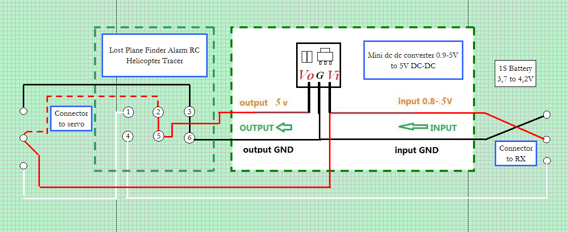

25 May 2015 13:20 #32955
Replied by mwm on topic Rescue helicopter micro with 1S batteries
Yes, the lost plane locator has to go between the Rx and the servo. It watches the servo line so it can go off if there's no activity.
Hard to say whether 5V will damage the servo or not. Why risk it? Just insert a resister in series with the servo after the locator to drop the voltage back down.

Resistor is not the way to go there. The voltage drop of the resistor will change with the load, and with a servo, the load changes drastically. If anything, using two diodes with a 0.7v drop could be used, but either is not a clean way to handle it. Why not keep powering the servo from battery and only attach the signal line?

Here is the installation I wanted to do because of 1 of the 3 plane lost locator the V + was welded on 2 different locations (see items 2 and 5), as I do not know how this circuit works, I wanted to do the same again. In fact the inputs and outputs V + (2 and 5) are welded together, as indeed V- (3 and 6). So it simplifies everything. The first scheme is red dashed line, the final red solid lines.
Which channel should I put it?
Thank you for your help.
saidem
saidem
