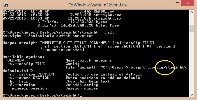

I was just testing straight.exe and noticed that it changes the line endings in the model.ini from <LF> to <CR><LF>. Will the model file still work in Deviation with those line endings?

28 Jul 2015 01:49 #36210
by greenfly
Replied by greenfly on topic Model file switch conversion utility
28 Jul 2015 01:56 #36213
Replied by mwm on topic Model file switch conversion utility
Have they changed Windows so it no longer accepts the forward slash in names? Or maybe that only works from the command line?
Anyway, it should be using backslashes on Windows. It should also be using AppData, not .config. It looks like it's getting the default config location - which is for Unix-like Systems - and not the Windows version. I'll poke at that some tonight.
Thanks for the report!
