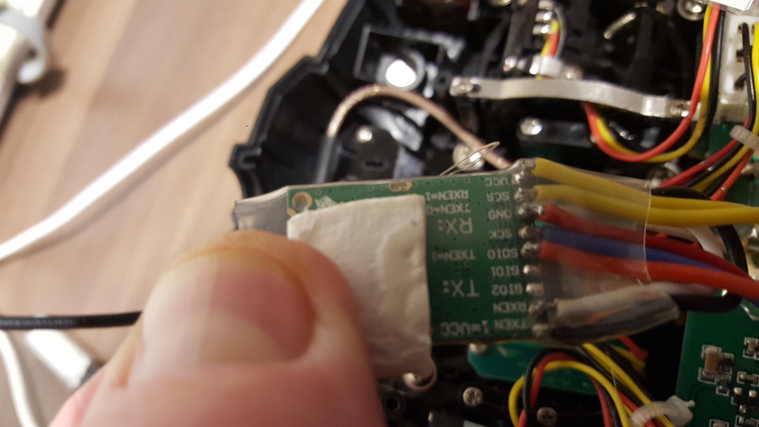

Hi all I am really getting stuck adding these modules, I have tried 2 NRF24L01 modules and one A7105 and I am getting know where with it. I have an older Devo 7E that I am unable to get modules to work in. I have installed the NRF a few times following static precautions on my bench and have had my Son check the wiring as per the instructions we found follow with the colors dots.
Modules used :
XL7105-D03 A7105 Modification Module Support Deviation Galee Flysky Bangood
2.4GHz 1100 Meters Long Distance NRF24L01+PA+LNA Wireless Module With Antenna EBay
I am running standard 4.01 firmware without the protocol .ini As soon as I install either module I get bad or missing protocol error , even before I edit the tx.ini to tell the transmitter it has the module installed. After seeing another user with this problem that was solved by getting a new NRF module I did this and got the same result , bad or missing protocol. I then have to format the USB files area and re load the older 4.01 firmware to get my radio working again. I have tried several firmware versions of the nightly type all with the same result. I am not too bad at soldering as I do quite a bit of it but this is beating me.
I have found it really hard to find instructions that I can follow, as there are a few variables of modules and ways to wire them up. I am looking for a picture that says with my modules ( see picture ) and this firmware do this. The color dots on a photo showing the wiring is easy to follow but what ever version I try I still get the bad or missing protocol error and a radio that will not work at all, until I remove the module, format the USB drive and re load the firmware.
Should I run the latest nightly, or is the standard 4.01 OK? which works fine for me in normal use. I am going to try again but I have done this several times now and even had some one else check the wiring to still have it fail every time. Could it be my radio being a few years old, causing a problem? I have had it for several years now and it has been a great radio I recommend them to everyone as a great park flyer radios especially with deviation firmware.
Modules used :

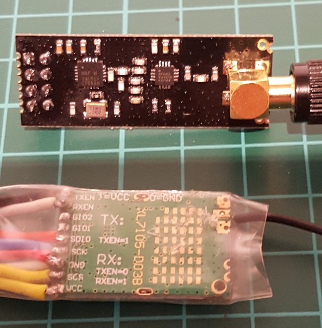

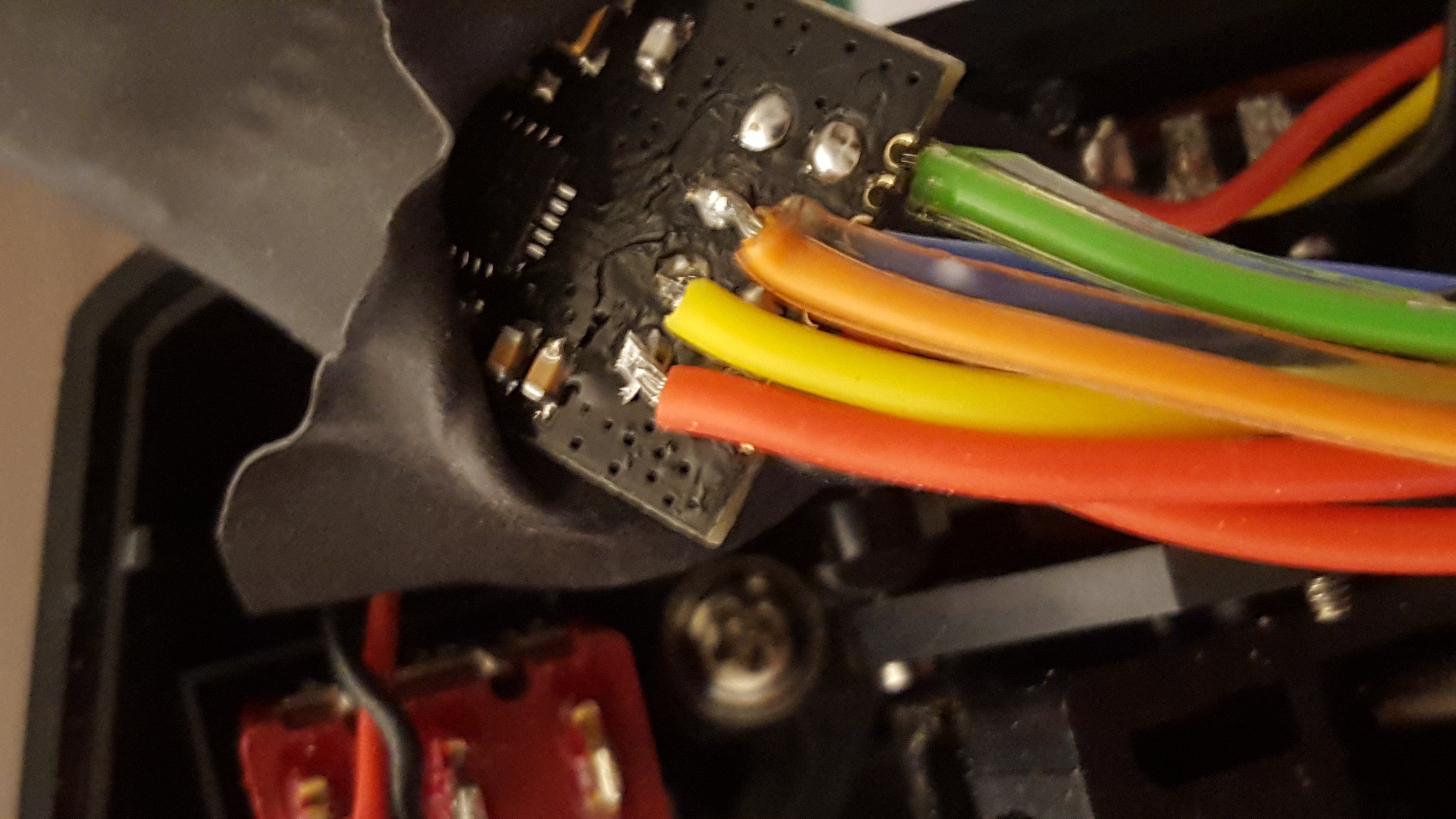

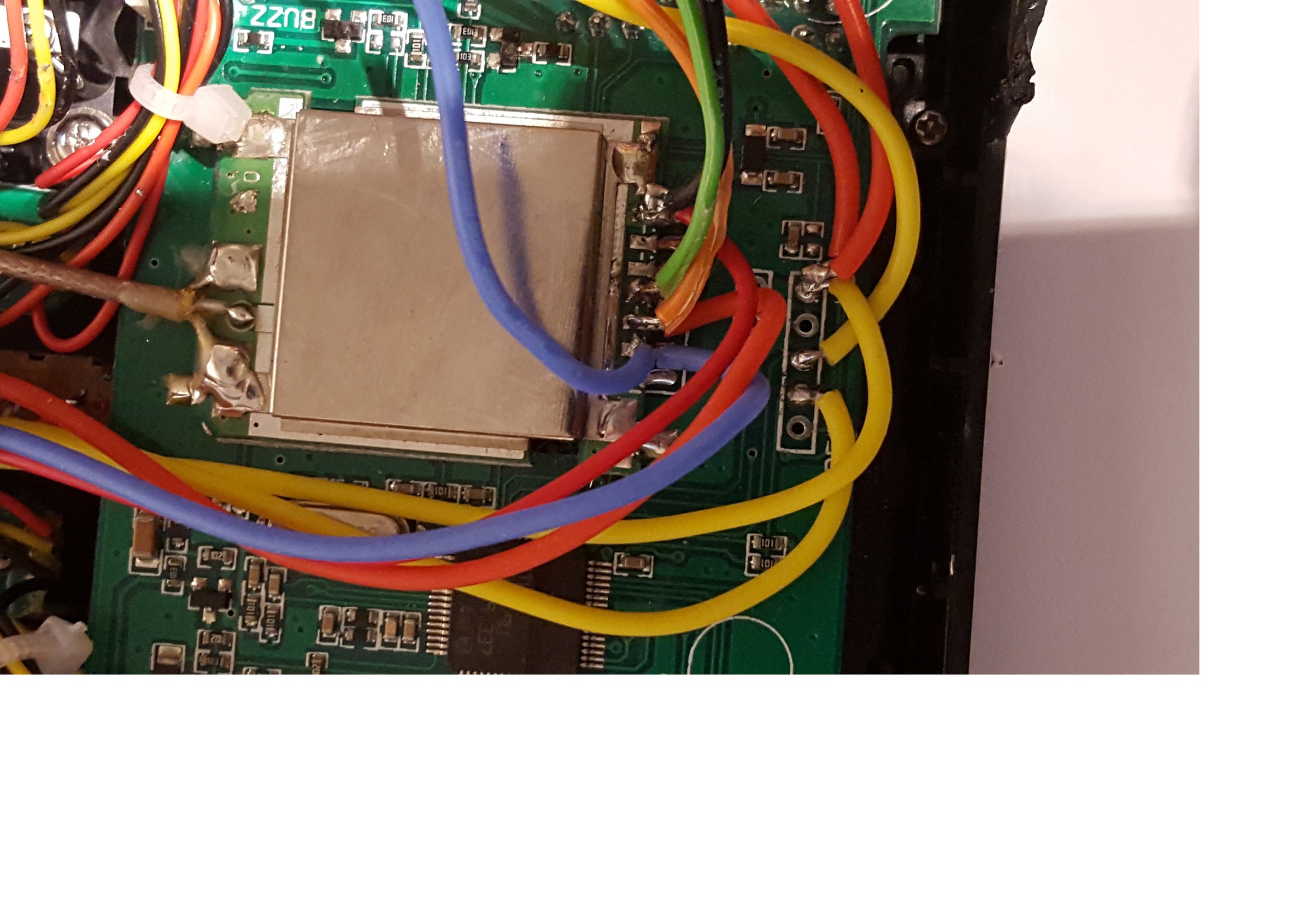

05 Feb 2016 05:22 - 05 Feb 2016 05:30 #42609
by Littlepip
Replied by Littlepip on topic Bad or missing Protocol with NRF24L01 and A7105
I managed to get a couple of picture if the can help
I can do better tonight if needed.
Also If I enable the NRF it shuts down the tx after a few seconds and the A7105 might be working now on A113 with pa 1 on 4.01 FW.
To change or upgrade firmware I have been formatting the USB drive and copping all the filesystem files over to the blank drive all bar the model directory that is, is this correct?.
I am also not sure if if I should be editing the tx.ini on 4.01 as there is no hardware.ini but that is what I have been doing anyway.
I installed the A7105 first and used the tx.ini file like this and the A line reversed i.e 13 to 14 etc. Below is my tx.ini I have tried both ways and I now am unsure which is the first way, sorry! it shuts down reversed from this.

I can't really tell if the wiring is correct, but it appears you've used all the right connection points. I don't think the FW version appears to be a problem; 4.0.1 is a fine system and should work in this environment. Of course you will want to take advantage of the advances and bug fixes in later "nightly" versions, but for now if your hardware is ok, it will work either way.
The TX.ini file should be set up to only indicate the devices you have connected. So for the modules section, you MUST use a semicolon (";") to set unused lines as comments. In my testing i usually enable one module first, then the other, then both. Start out by just having all the lines commented out, by putting a semicolon in the first position on each line. The TX should boot up and allow you to see 4.0.1 with usable protocols for DEVO and DSMx/2 but no others are usable. Note that you'll probably see a lot of protocols, but anything with an asterisk ("*") in front of the protocol name (e.g. *Hubsan), is not usable.
Then remove the semicolon from the lines for the A7105. This should allow you to boot and see additional usable protocols (Hubsan, Flysky). Now disable the A7105 and enable the NRF and you should see other usable protocols (V2x2, Hisky, ....). If this is all working you can then enable both the A7105 and NRF modules.
If this corrects the problem, let us know.
