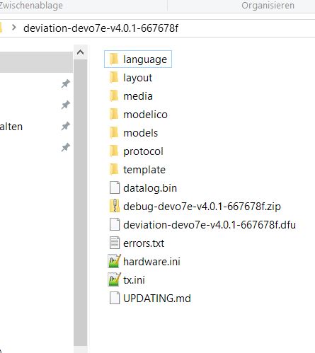

21 Feb 2016 20:24 - 21 Feb 2016 20:31 #43430 by Sero
Replied by Sero on topic Nightly Builds Update Devo 7e
I checked in the latest nightly, and it seems to be the full monty, including a hardware.ini...

21 Feb 2016 21:38 - 21 Feb 2016 22:02 #43432 by jamichx
Replied by jamichx on topic Nightly Builds Update Devo 7e
FDR wrote: There will be no user manual for each nightly build, because as you probably know, nightly builds are the result of an automatic build system, and are built every time there is a change in the code.
The documentation tries to cover all aspects of this firmware whether it is an "official" release or a nightly build.
There might not be any official releases anyway, so get used to the nightlies...
well this statement does not help me to understand how exactly proceed when updating nightly builds does it ? So again back to my question how exactly do I upgrade from older version of nightlies to new one on devo 7e ? I need explanation of that procedure exactly how to do it. What to install new what to copy what to keep from old version so after I finished I end up with working hardware and all may settings intact. I hope I made my self clear this time. It would be very good if someone made this kind of general procedure manual.
And there is still the other question I asked unanswered. Do I need to upgrade is it essential even my old version is working ? Thanks to who ever will be able to answer.
Here is the example of possible answer> if you look at the Sero's picture above with all the files and folders. I need someone to say first you need to use dfu file to update the firmware then you copy these and these files over but make sure you keep these and these old files and folders. Something like that for devo 7e
