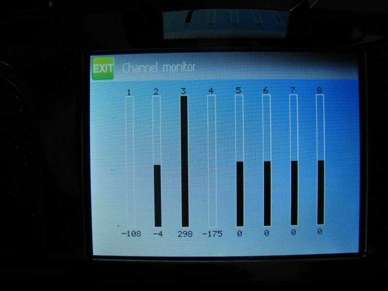

08 May 2013 05:46 - 08 May 2013 05:53 #9698 by Wene001
Replied by Wene001 on topic USB HID Joystick & PPM-In program
started again with two default models and now it works as you described.
if i use the train option i cant see anything on the bars on main screen.
only on the monitor page of the mixer.
thanks for programming this cool feature
for me it would be more intuitiv to have the channels 1-4 in the left column on trainer config page. and channels 5-7 on the right side.
on the ppm out page i would prefer displayed 1500 ms as standard for the complete pulse (high and low)
Last edit: 08 May 2013 05:53 by Wene001.

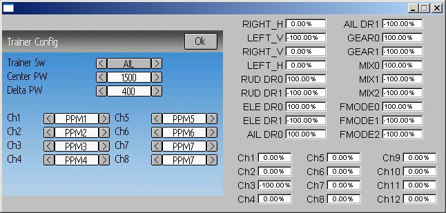

09 May 2013 06:39 - 09 May 2013 06:42 #9729 by vlad_vy
Replied by vlad_vy on topic USB HID Joystick & PPM-In program
I can select up to PPM9 for 8ch mode (Trainer page), up to PPM7 for 6ch mode. Is it normal? And, possible it will be better to fill absent channels by 'None', but not the last available PPM channel.
Also, why by default 'Trainer sw' is AIL? Possible will be better by defaul use most usable switch (for all possible Tx), or add 'None'(Off) as default.
Last edit: 09 May 2013 06:42 by vlad_vy.
09 May 2013 08:10 - 09 May 2013 09:12 #9731 by BitOne
Replied by BitOne on topic USB HID Joystick & PPM-In program
Hi Guys,
Trainer and PPM-In are wonderful features ! Thanks a lot for that.
I have a small question or remark: from the picture above, it seems that the PPM Inputs from the slave are mapped directly to the output channels of the master, without going through the mixer on the master.
I realized it matches what PhracturedBlue described previously :
1) Trainer mode: In this mode each input channel is mapped to an output of the transmitter when the relevant switch is enabled, otherwise the channels act as normal
So it means that all the mixers, trims, safety switch settings, etc... must be done on the slave transmitter, as well as on the master transmitter. And the two setup must produced the same result (not easy when you have two different software on the two TXs).
In my case, it does not work very well: I have a DX5 transmitter that I would like to use as slave and my Devo 8s as master. As the DX5 is not programmable, I cannot use it with this mode in Deviation.
Same at my club: the slave TX is a very simple non-programmable transmitter. Could even be a module-less cheap one, as it's only used as slave TX.
The use case where the more advanced TX is the slave can occur too (and this is the one covered by Deviation as I understood it), but I have the feeling that in a lot of situation the more powerful TX will be used as master as it has for example the highest range.
Could it be possible to implement both ways and to choose which one from the configuration :
- PPM inputs from slave TX mapped directly to output channels on master TX
- PPM inputs from slave TX override master stick inputs (so the inputs will go through mixer and master TX configuration)
Or maybe with the PPIM In mode (the FPV one) I could emulate what I want by using a mixer, a switch and virtual channels linked to the PPIM In to do the overriding, at the cost of a complex setup and modifying each model setup to enable trainer input.
Last edit: 09 May 2013 09:12 by BitOne.
09 May 2013 12:54 #9743 by PhracturedBlue
Replied by PhracturedBlue on topic USB HID Joystick & PPM-In program
I assumed that you would want the slave to behave as if the owner was flying it, but you bring up a good point that it would result in a difference in behavior when going to master-mode if the configs didn't match.
How do other transmitters handle this?
You can of-course use the 'FPV' mode to achieve what you want. it requires using advanced mixers everywhere and having the 1st mixer be a 1:1 mixer, the 2nd mixer use the train switch to override with the proper PPM input, and the 3rd and higher mixers to apply whatever curves or d/r you want.
However, if the current 'train' mode isn't valuable, then I could change the behavior to be an input override instead. Not having ever used a trainer, I may not have been the best person to implement this feature :)
