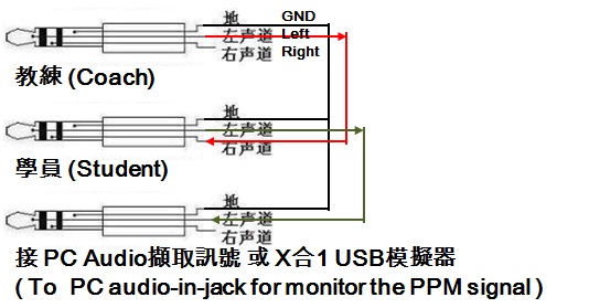

(1) the Walkera Cable
(2) my cable (my own ideas in this ppm-in program)
- Coach : select PPM protocol , PPM out-put (audio-left)
- Student : select PPM protocol ,
this program will get PPM in-put (audio-right) then out-put (audio-left).
- Monitor :
Use PC to capture the PPM out-put (audio-left) from Student.
Attachment Walkera_cable.jpg not found
- Monitor :

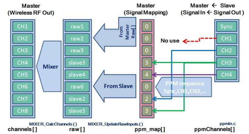

I checked in the full support for PPM-In using both 'train' and 'fpv' (actually named 'input') mode.
I've done some testing with my Devo8 & 10 and things seem to work ok so far.,
Note that the 'Center PW' in 'PPM In' is not the same as the one in the PPM protocol.
the PPM In 'Center PW' is equivalent to the PPM-Out 'Center PW' + 'Notch PW'
So 'Center PW' will generally be 1500 in the PPM-In configuration

The Master should have the proper protocol set and set 'PPM In' to 'train'
Then click on 'Train' and make sure that the PW values are set properly as well as setting a toggle switch.
You can choose to change the Master-Slave channel mapping as well. This works by taking the specified channel in the spin-box from the slave and applying it to the specified Master channel. Thus if you set:
Ch3 = <Ch5>
It means that Slave Ch5 will be attached to master Ch3
Now turn on the slave.
you can now toggle the specified switch and the Slave values will be passed to the radio on the Master.
You should be very careful using it. The code is very new, and probably has bugs.
If you lose a connection with the slave the channels will hold their last position until you flip the toggle back. I'm not sure that's the right way to do it though, so feedback would be appreciated on the whole thing.

I'm sorry to cause misunderstanding, I should have to provide this photo before.
I use the stereo audio jack, the Walkera is mono jack, they are different.
