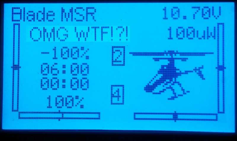

Maybe the same functionality could be achieved for less effort by using a text formula that users can input themselves. This way you guys don't have to worry about language files, or making beautiful icons for b/w screens and everybody gets what they need and want?
IF you could define 2 or 3 switches to a text status summary then you don't have any space or icon issues for us monocromerz, just keep the current icons and switch setup plus something like this...
THx ON + DR low + FMOD0 = "READY!"
THx OFF +DR low + FMOD0 = "FLY!"
THx OFF +DR low + FMOD1 = "3D!"
THx OFF +DR Hi + FMOD1 = "Crazy 3D!"
THx OFF +DR low + FMOD2 = "WTF!"
THx OFF +DR Hi + FMOD2 = "OMG WTF!"
I certainly wouldn't complain if icons end up working in low rez MonoC, but a status summary might be visually more effective for our lil' screens vs. effort required :)
Thanks!
Cheers!
