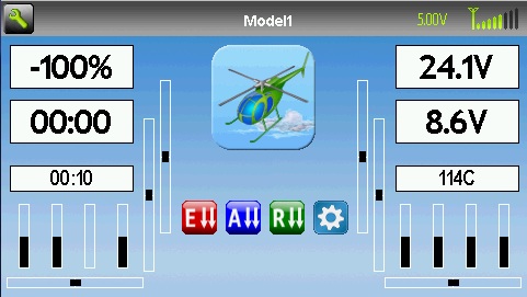

I've just been playing with it to allow more info on the main page. Meaning if you have the extra boxes on screen we don't need to hide the icon.
--removed pictures; see newer ones below---
I'm going to move the icon to the center and the boxes to the outside, but have to feed the kids...
Last edit: 26 Feb 2013 04:07 by Hexperience.

24 Feb 2013 20:10 - 24 Feb 2013 20:12 #6984
by Hexperience
Replied by Hexperience on topic Emulator for Devo12 (big screen) ready

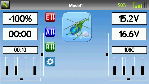

Getting there...
I will move the toggle icons under the model icon. But after that it will be pretty spread out so I'll let everyone else start talking about any changes for the devo12 gui
Last edit: 24 Feb 2013 20:12 by Hexperience.

For the many switches we could have a second column of toggle icons right of the icon. Increasing the number would not be too complex.

Sounds good. I've entered a pull request so you can take these changes back. Increasing the number of icons will be more than just rearranging the existing objects. I'm not that good..

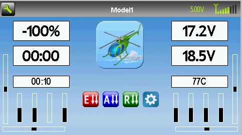

Ok, I think I have the main screen spread out so there is very little that needs to get hidden. The trims will offset the bars and boxes as they did before but 6 trims will not hide the icons.
So far these changes are only in my repo and will get pulled back into RBE's repo. After that... some time RBE's will be pulled into PB's.
I basically did this to start learning the code a little and for my own use.
ps. this doesn't break the devo8 emu anymore.. I get it now..

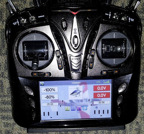

Good point, but only if the trims are on the outside, and so far I've only hacked around the existing objects. At this point I will let the code go back through the eyes of RBE and then PB. I'm positive that there are better ways to code what I've done so I'll let the experts look at it. But as RBE said, these are the kinds of ideas that we can start talking about and have a clear picture of what we want the displays to look like.
By the way... I know I post too many pictures, but I can't resist...
My devo12...
All I need now is for the code to play MKV's ...
My devo12...
