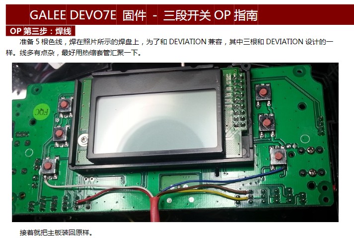

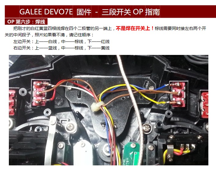

02 Sep 2013 15:05 - 02 Sep 2013 15:06 #13492 by cmpang
I was the one who pointed out the possibility to add two more switches in the 7e and from then a happy user after PB has implemented it Deviation.
About half year ago, I was so surprise to find that a Chinese hobbist who has based on Deviation to provide a variation (sadly GUI in Chinese only) that incorporates two three position switches. Obviously, I too have the query the same as yours as there is only two unused switches left in the stock 7e.
The attached diagram show how it is being connected.
Trust me, ever since then I have used his version since May last year and not a single problem ever since.
After some thought and a hint given by Gale the author, the trick is since we have to use a reverse diode for the usual two switches upgrade anyway, why not add two more diodes to some other input point AND scan the switch matrix one more time but in reverse COL / ROW order. That is, if we did send signal out to COL and listen to switch closure from ROW, then the second scan is to send from ROW and listen to COL and only pay attention to the four target cross points.
It is a pity that there is not much space left on the 7e panel, otherwise I think even more switches can be added.
Last edit: 02 Sep 2013 15:06 by cmpang.
02 Sep 2013 15:21 - 02 Sep 2013 16:18 #13494 by cmpang
A bit more..
the two new position Gale added the diodes to is on the "Ail Trim left" and "Elev Trim up" cross point. And the Added switches are named "Ail D/R UP" and "Elev D/R UP". The original twoo added switches are thus "Ail D/R DN" and "Elev D/R DN"
Since there is no such thing as free lunch, it does has a limitation but that is of no border to me during actual usage ...
1. while you are pressing the "Ail Trim left", there would be no instant respose if you flip the "Ail D/R" switch. Not until the time you release the Trim switch then the switching action goes.
2. same for the "Elev Trim UP"
A very clever idea, isn't it?
Last edit: 02 Sep 2013 16:18 by cmpang.
