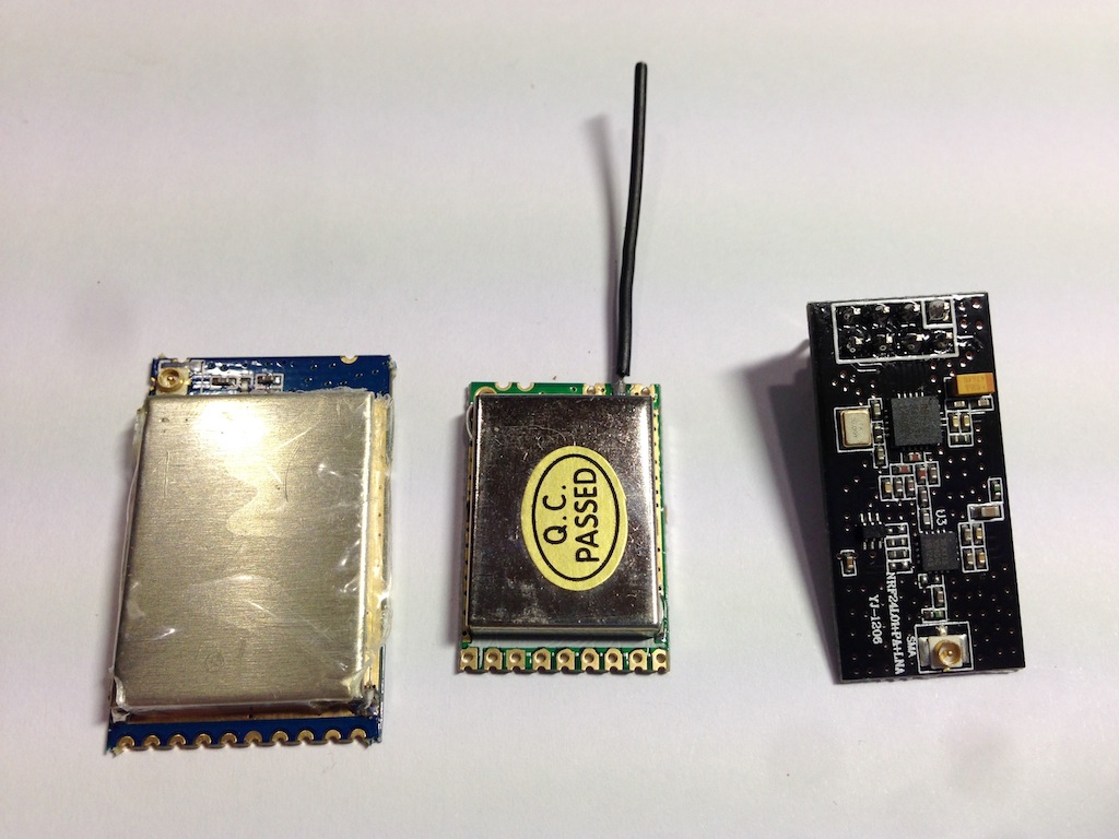

phantom8 wrote: I've installed the multi-module with A7105, NRF24L01 & CC2500. A7105 & CC2500 works fine. However, I'm having problem with NRF24L01. It's rather strange, the V202 protocol doesn't seem to work, but KN protocol works perfectly. Both V202 & KN use NRF24L01. I don't understand why V202 doesn't work. When I tried to Bind under V202, it counted down from 3 seconds to 0 and stayed at 0. That is, the bind screen never exited. I remembered it would exit the Binding screen when not using the Multi-module. Any hints?

I've done some more testing. Removed the NRF24L01 from multi-module and connected it to Devo 7e directly and it worked perfectly with V202 protocol. Putting it back to multi-module and V202 didn't work. The thing that puzzles me is why KN protocol works; while V202 doesn't. They both use the NRF24L01 module. I have triple checked all my connections for short and cold solder; and there doesn't seem to be anything wrong with the connections.
[EDIT]
More testings:
Case 1:
In the hardware.ini file, if I only enable multi-module with NRF24L01 (A7105 & CC2500 disabled), Devo 7e will boot up with a message saying "Missing Modules: CYRF6936".
Case 2:
In the hardware.ini file, only enable MM with A7105, Devo 7e will also boot up with "Missing Modules: CYRF6936".
Case 3:
In the hardware.ini file, only enable MM with CC2500, Devo 7e boots up normally.
Last edit: 13 Jul 2014 01:45 by phantom8.

Replied by phantom8 on topic Developing a universal module
SeByDocKy wrote: As you can see in my tutorial video, I don't have such msg when I am enabling only 1 chip..... Strange....
Do you have the 1.2/1.3/1.4 version ? How did you flash the ATTiny ? which version you have ?
When I had installed the first module A7105 into the MM (NRF24L01 & CC2500 are not installed at the time), I tested it with Devo 7e and it worked and there were no missing CYRF6936 message. I only had that message when I installed all 3 modules, but only enable A7105 or NRF24L01 alone.
I've the v1.3 MM ordered from oshpark. I only have a Devo 7e, so I flashed my ATTYINY24A-PU with Usbasp. The AVR.hex was downloaded from the download section of this forum which labelled Rev3. The flashing instructions was obtained from wiki as follows.
avrdude -p t24 -c usbasp -e -U flash:w:avr.hex
avrdude -p t24 -c usbasp -U lfuse:w:0xe2:m -U hfuse:w:0xdf:m -U efuse:w:0xff:m
I'm out of ideas.

Maybe because you are using a Devo7E ?. Which modele of nRF24L01, A7105 and CC2500 did you install ?

SeByDocKy wrote: Maybe because you are using a Devo7E ?. Which modele of nRF24L01, A7105 and CC2500 did you install ?
Am I the first one who installed all 3 modules into the Devo 7e? I thought PB and some others have done it before. As for the particular model of the modules, I believe I picked the most popular ones. Here is the photo of the ones that I'm using.
