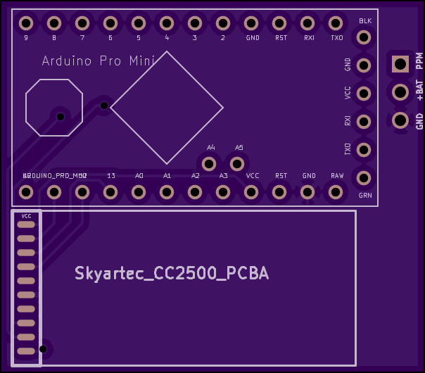

I think in the mean time, I'll just use the ppm pcb module (it's 38.38x33.68 mm should fit without issues) I designed, based on LittleMo schematic, and deviation skyartec protocol ported to arduino.
lunarflow.com/index.php?topic=8.0
And put it the devo7E plugged internally to the trainer port.
So I would have A7105, nRF24 on the spi bus and choose PPM for the skyartec wasp nano CP.

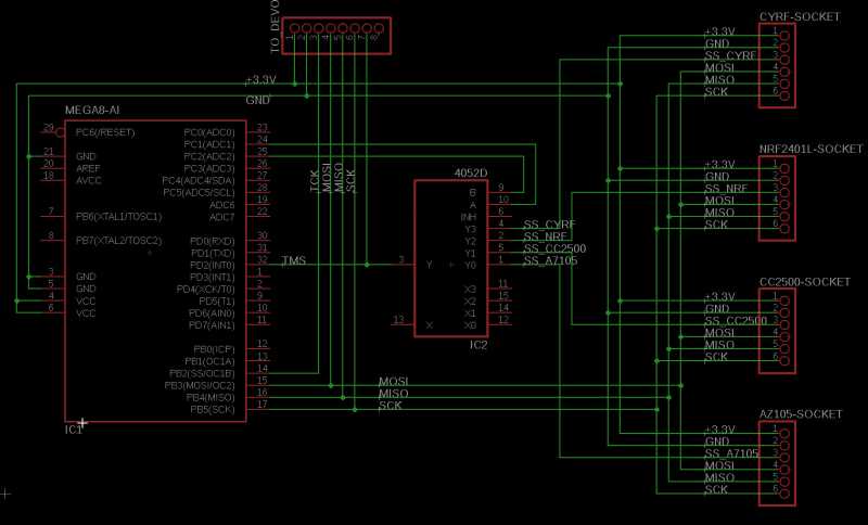

No switch needed, actually. And there is better scheme which allows to use one of TMS or TCK to control both the extender and specific radio chip, and another to be used as an extra line to some chips which need it. And use Mega's ADC to add analog output.
I planned something like this, but spent last couple weeks reverse engineering and debugging Tactic SLT. I'm done with it and returning to extender.
The proposed schema is the following (mind you, I did not invent it, but learned, studying some SPI ADCs):
If you lower CSN (which can be TMS or TCK) and without clocking return it back to high, the extender recognizes it as an attention, and next SPI command goes to it. The command can switch the active device to any of RF chips, so then you communicate with them directly, using the same pin as CSN.
When the device is selected, ATMega can pass CSN signal in an interrupt handler quite fast, so no switch is needed.

Another (may be easier) plan is to use a switch - I know, I said it's not necessary, but may be I was too optimistic.
My initial design was a switch and a shift register - 595, but I could not design it so that in the reset state it just behaved as if it is not there, but the traditional TMS/TCK is used for a couple of RF chips. It would simplify the development because it would make hardware backward compatible with the software and one of my other goals was easiness of modification - no discreet wires, only attachment board and ribbon cable to module board, modules mounted in strict order - no room for human error.
