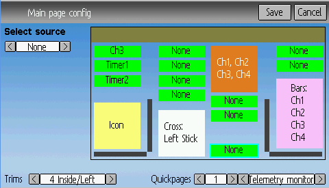

I started playing with it, and it is looking good.
There are definitely a few bugs with the configuration. See the following image which is a state I don't think should be possible:
Also, I don't think there is a need for a long-press option. when you short press an object for the 1st time, select it but don't change the object type. then show its config on the left. now when you change its type, you can redraw the options of the left for it. And then get rid of the 'ok' box. You already have a 'save' which should be sufficient

PB, thanks for looking. Your idea for changing type seems to be good, I will give it a try.
The picture in your post is possible and intended - the elements under the preview do not fit on the screen but you can change their type so they jump up. But I am also not satisfied with this - I will think about this again.
OK and save button: ok is for the parameters of the selected item, save is for the whole page. But with the above idea it will not longer be necessary.

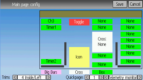

04 May 2013 21:34 #9567 by PhracturedBlue
Replied by PhracturedBlue on topic devo 12 wide screen...
Thanks, I think it is a lot better now.
Still a few issue to work out. For instance in the following:
It is not possible to put a cross into column3 below the 'short bars' which I think should work fine.
Also, there should be 4 4 small boxes in column3 in this configuration. I think it isn't there because I had previously configured one of the boxes as a cross. when I go back and mark it as 'none' I do get 4 small baoxes as expecte d(but I still can't properly add the 2nd cross)
In any case, getting the logic right will likely be tricky, but I am much happier with the way it is working now. Thanks for all the hard work.

05 May 2013 06:07 - 05 May 2013 06:11 #9577 by rbe2012
Replied by rbe2012 on topic devo 12 wide screen...
Maybe I shall re-introduce the "empty" element and reset all elements falling out of the screen to this.
AS a workaround you can select one of the boxes above and change it to cross. At least with the uppermost it should work. But (I just tested it) if one of the invisible elements was a cross the two allowed crosses were counted and a third is not possible. The "empty" element would resolve this so the best will be thinking about this again.
EDIT: Do you think a non-used element like the two upper boxes in the third column should be removed when I select the lowest to be a cross? This can be done, but I am not sure what to to when you work with an element which is not the lowest: placing it where it is when it fits, moving it up until it fits (with removing empty boxes) or moving it up as much as possible?
Last edit: 05 May 2013 06:11 by rbe2012.
