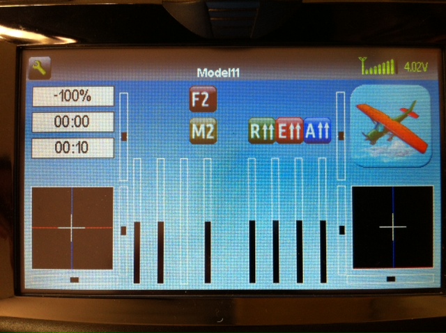

15 May 2013 17:31 - 15 May 2013 17:55 #10034 by Wene001
Replied by Wene001 on topic devo 12 wide screen...
good work rbe
but one thing i don´t like is the gap between the two middle columns in this view
Also it would be nice to have ppmin as input for the bars in the middle of my picture
Last edit: 15 May 2013 17:55 by Wene001.

15 May 2013 20:21 #10040 by rbe2012
Replied by rbe2012 on topic devo 12 wide screen...
The gap looks so wide because there are no trims to fill them. This needs some fine tuning.
PPM inputs for bars are not available in the main deviation development but easy to add. I will think about this, but as long as the PPM in development is not finished this might change again.
15 May 2013 22:33 - 15 May 2013 22:33 #10043 by RandMental
Replied by RandMental on topic devo 12 wide screen...
Wene001 wrote: good work rbe
I would not necessarily see the gap as an error nor as a bad thing - having 8 equally spaced bars will be confusing for the normal eye. Although nice and symmetrical, it requires one to "count" to identify a specific bar on the fly. Normally you would have groups of up to 4 items which the brain can decode on sight, there after one split it into subgroups of 2/3, etc, to allow an intuitive recognition and grasp of the information presented.
(Just a suggestion based on a bit of experience in these things)
Last edit: 15 May 2013 22:33 by RandMental.
