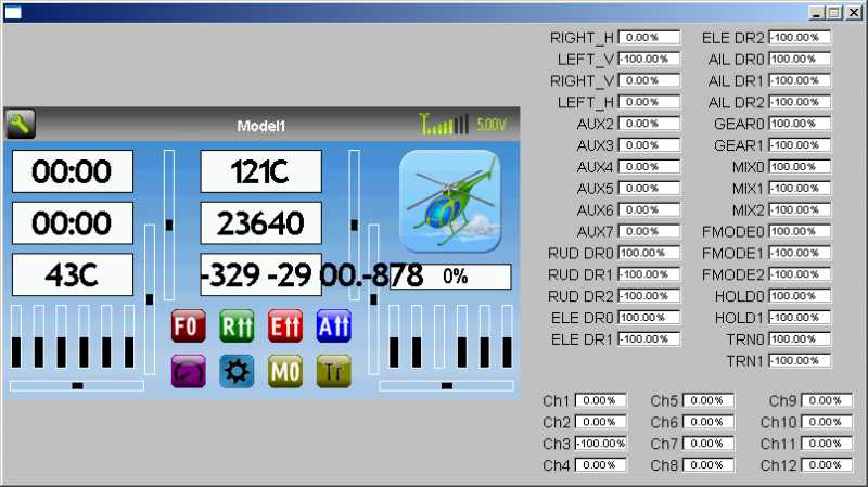

Replied by vlad_vy on topic PB's newgui
PhracturedBlue wrote:
vlad_vy wrote: Without any specific idea, to fill screen only.
It looks nice, and if you provide the ini file, I'll add it to the templates, but the default should be for the most-common setup:
6 channels and no telemetry
I agree, it's overladen layout. It's only example of objects placement with most controls on the screen. I will send ini file later today, as soon as I return to home.

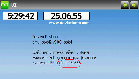

25 Jun 2013 05:33 - 25 Jun 2013 08:56 #11327 by vlad_vy
What does it mean? And emulator eventually exit at translated USB page.
Also, will be nice do not refresh values that not changed on time for refresh (date, telemetry values and so on). If 'new value' = 'old value' then do not refresh. At that case values will not flicker, and it will reduce resource consumption.

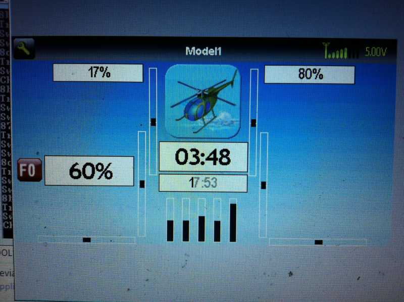

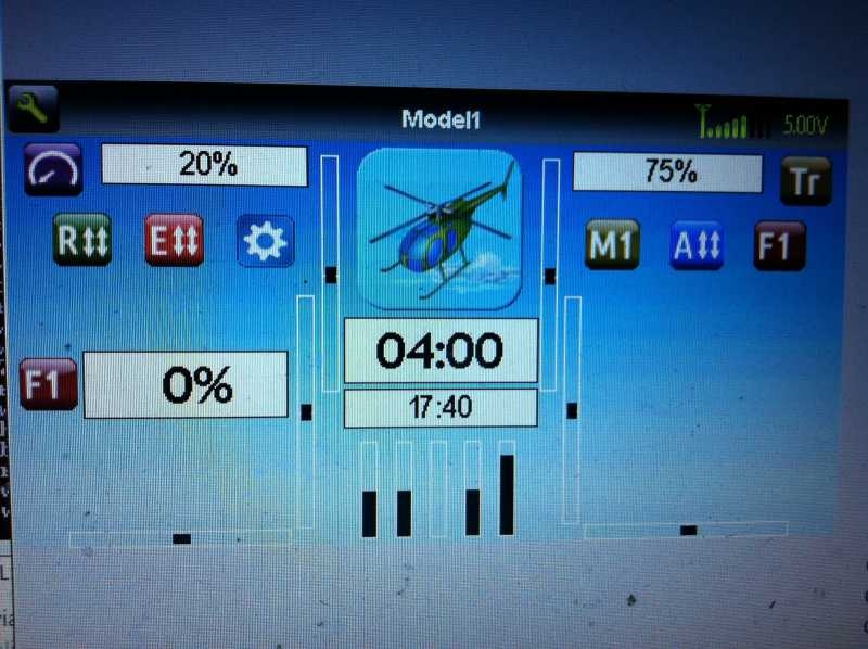

25 Jun 2013 06:03 #11328 by Kdean
Replied by Kdean on topic PB's newgui
Here is what ive been working on. This will be how i layout my gui when the version is released.
It shows all toggles when the switch is activated, two boxes for knob values or can be set to show pitch and gyro gain like i did with this setup. A big box that displays the thottle output from 0% to 100%. Its also reflects the changes made by flight mode and throttle hold switched. I also have the gyro % channel set with the mix switch and values are displayed in the box above the mix toggle.

25 Jun 2013 19:29 #11353 by PhracturedBlue
Replied by PhracturedBlue on topic PB's newgui
I've fixed several more timer/rtc related bugs, and added the ability to see the date as well as the time on the front page.
I also fixed the trims in the template for all Tx types.
I fixed the usb page for the Russians as well.
