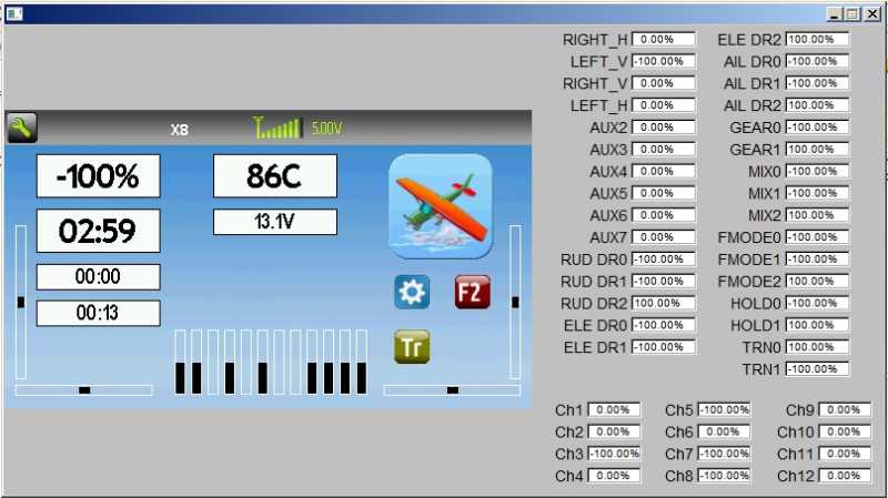

19 Jun 2013 14:58 - 19 Jun 2013 15:09 #11121 by Pattaya01
Replied by Pattaya01 on topic PB's newgui
I've been playing with it for a while now and it suits me fine. I can place elements where and how I want. It takes a bit of time, but since you only do this once per model, that doesn't matter. There may be some cosmetic improvements possible, but I did not encounter any bugs. (sofar)
This is an example. I like the clean and aligned positions of the elements:

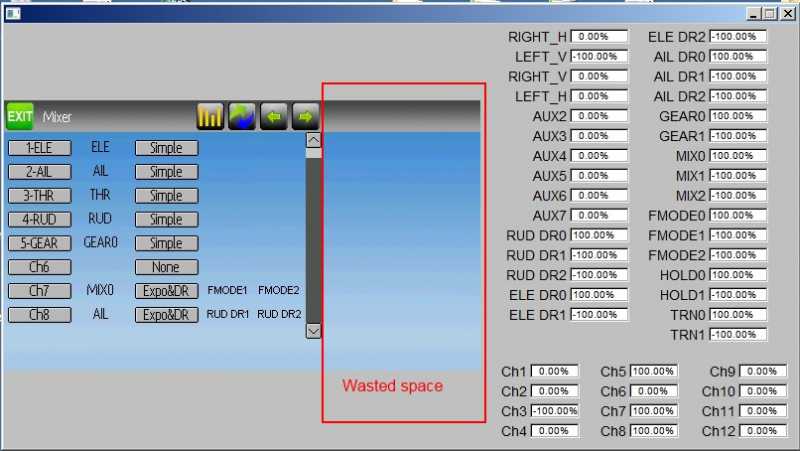

What I don't like is that all other screens do not use the full wide screen of the 12S
