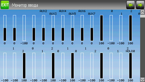

PB, is it possible to use at 'Input monitor' screen not translatable text labels? As for AUX2, ... AUX7. For example, with russian interface it looks very strange.
