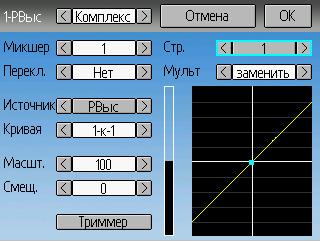

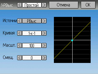

PB, can you move text labels at 'Simple' mixer page to the left, as it is at 'Complex' mixer page? Russian label 'Src' doesn't fit.
Aslo, is it possible to draw thin horizontal lines (or thin dashed lines) at graphs,
at levels -100% and +100%?
