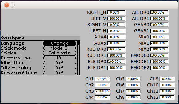

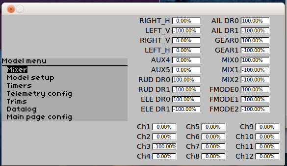

Just something I've been working on for a while. This is the second go at it my 1st was lost in a HDD crash and put on hold for about 6 months.
I have it mostly working but I'm still hunting pixel level inaccuracies and it's going slowly since I can only work on it late at night when I'm usually very tired.

13 Dec 2013 14:03 #16577 by PhracturedBlue
Replied by PhracturedBlue on topic WIP / Devo 10 (eventually 7e) condensed GUI.
It does look very nice. Is there anything here you can't do with just a theme? You didn't show anything in these screens that i see that couldn't be done by redefining the main-page layout and getting a good small font. Maybe alignment issues I guess. And the number of items per page may be hard-coded. I'd love to have enough flexibility that someone could get this with just a theme though.

13 Dec 2013 16:17 #16580 by sbstnp
Indeed, number of items is hard coded and there is a plethora of small pixel misalignments when sizing down most GUI elements and re-writing some parts of different pages to account for the increased number of elements.
I intend to go the whole mile and then if it looks all right maybe we can make it an option for latin alphabets. I haven't checked accented chars yet so I'm not sure they will work with that particular font, but modding the font should be the easy part. English looks perfect so far, so for it's worth the effort.

13 Dec 2013 16:59 #16581 by rbe2012
Replied by rbe2012 on topic WIP / Devo 10 (eventually 7e) condensed GUI.
It is great - much more usable than only four lines.
sbstnp, do you use a smaller font or do you recalculate an existing font? With the first we could try to calculate how much lines are possible on the screen and adopt scroll areas and line spacing. I have done similar (for only a few pages) when I optimized them for the 480x272-screen.

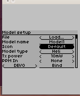

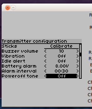

Ok so I got a little time to work on this some more.
I started with a new fork and pushed most of the changes here:
bitbucket.org/sbstnp/deviation-bw-small-ui
I'm still experimenting with ways of tweaking the UI widgets and keep the existing code as much as possible so far. Unfortunately there are many many assumptions about font sizes and how things are placed on the screen and spacing.
Some more pix, buttons are now underlines when not selected (not definitive but looks cleaner) and I changed some labels (won't happen if I'm to keep compatibility with 12 pixel fonts, but it looks nice):

Love it. Would be good on the Devo10 too. My I make a suggestion about the buttons (just not feeling the underline). Is there a significant visual difference between <> and (), if so perhaps the buttons could be
(  Calibrate  )
as in the image above rather than Calibrate

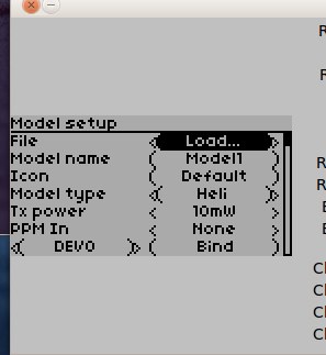

27 Dec 2013 15:34 - 27 Dec 2013 15:40 #17103 by sbstnp
Big problem when the button will be inside <>, it wiil look kinda weird, like <( Load..)>. Actually weider on a small font. Will put pix up in 5.
Edit: pic.
Not liking this. But I have another idea, stay tuned.

27 Dec 2013 16:37 #17112 by HappyHarry
Replied by HappyHarry on topic WIP / Devo 10 (eventually 7e) condensed GUI.
this is looking good, though is there any reason to have the parts that cant be scrolled through left and right inside brackets at all? so have those that can be scrolled through inside < > and those that cant not inside brackets at all?
27 Dec 2013 16:55 #17114 by FDR
What about sqare brackets?
[button]
<[spinbutton]>
27 Dec 2013 16:59 - 27 Dec 2013 17:01 #17115 by WheresWaldo
Replied by WheresWaldo on topic WIP / Devo 10 (eventually 7e) condensed GUI.
It sounded good in my head, but seeing the <(Button)> combination doesn't appeal to me either.

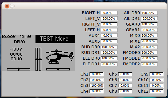

One thing I saw above and really like was the TX Battery and TX Power on the same line at the top. Can it be placed in any position with your mods? I never liked that the Power was below the battery on the Deviation screen and you cannot move it.
Secondly, are you also minimizing the toggles, I tried it on the standard file system. I redid the togglex.bmp smaller but had to keep the original .bmp size. While I could get smaller ones to display, the space allotted them on screen was still too big and you cannot overlap them without display issues appearing.
Third, was DEVO the test model name or is it displaying the Protocol?

WheresWaldo wrote: One thing I saw above and really like was the TX Battery and TX Power on the same line at the top. Can it be placed in any position with your mods? I never liked that the Power was below the battery on the Deviation screen and you cannot move it.
You know, all you need to do is ask :)
I've implemented the ability to move (or remove) the TxPower and Battery indicators on the main page. This is 128x64 only for now, and it looks kinda ugly on the layout page due to interfering with the 'Move' label. I'm not sure what to do about that yet.
