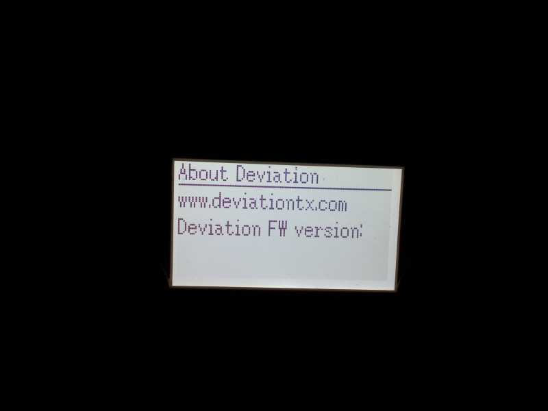

31 Dec 2013 16:56 #17582
Replied by PhracturedBlue on topic 7e layout editor issue
Your model works fine for me.
What version of deviation are you using?
Main Menu->About Deviation
