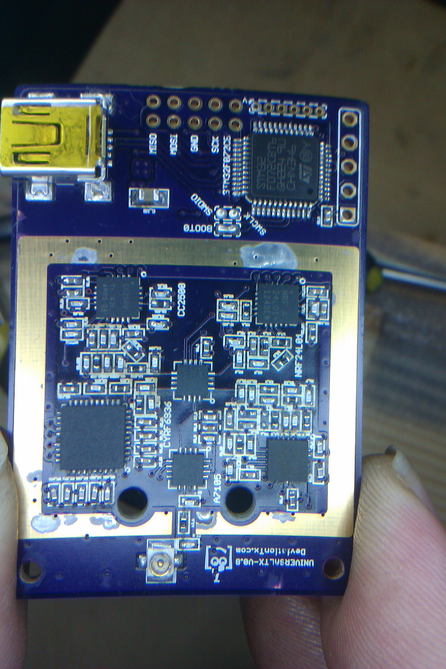

Fun begins, everything is here!

Replied by HappyHarry on topic Single-Board Universal Module
are you doing this by hand?
- SadSack
- Posts: 317
18 Jul 2014 23:00 #24683
by SadSack
Replied by SadSack on topic Single-Board Universal Module
I am indeed, I failed badly making stencils. Using iron and re flow blower. Easier then you think and slow as you would expect.
all being well should have this 1 of 3 made to day. PB has been busy with test code not sure how far off that is. Sure there will be issues with my bit, hopefully not many...

For 3 test boards, total cost was ~$150 US. That includes boards from OshPark, and parts from digikey and aliexpress, and all shipping charges (actually I don't think there were any). Not included is obviously SadSack's time.
So these boards cost $50 each (of course since we don't have a stencil, we might only get one board assembled of this batch. I will need to do a 2nd run of boards to fix the xtal, and I'll order a stencil at the same time.
Hopefully we can learn enough from this one that a 2nd spin is all we need though.

Not saying everyone should make there own. Once few pads are adjusted and few parts moved and my cockup fixed
Armed with a good stencil + blower ($47) and some care its doable, its not for everyone.
