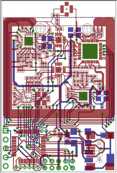

I did some work on placement. The outline here shows the size of a Devo module, which was my target size. It doesn't look like that will be possible though. I was able to squeeze all the components in, but I don't think the ground plane will be robust enough, and I don't think I have enough room to actually route the design (the bottom layer needs to be a ground plane under the RF portion to perform properly). I'm currently trying to figure out how big I can make the module and still fit it into all Devo radios.
I wasn't able to fit the headers onto the board, so those are likely to be casualties (only preserving the Bluetooth and Devo ports)
If I can add 5mm in width and 2 in height, I think everything will fit.
Attachment UniversalTxPCB.JPG not found

Replied by victzh on topic Single-Board Universal Module
It looks like 5-8 hours of placement work!

Honestly, I'm not even considering doing it myself. My hands just aren't steady enough, and therse parts are really small. Ideally I'll team up with someone to get the boards produced. Worst-case, eventually I'll pay to have a set of prototypes run through an APCB shop.
I got my F072 discovery board in the mail today. I'll need to hack up one of my nrf modules and see if the interrupt is fast enough soon. Probably not this weekend though. Other stuff going on.

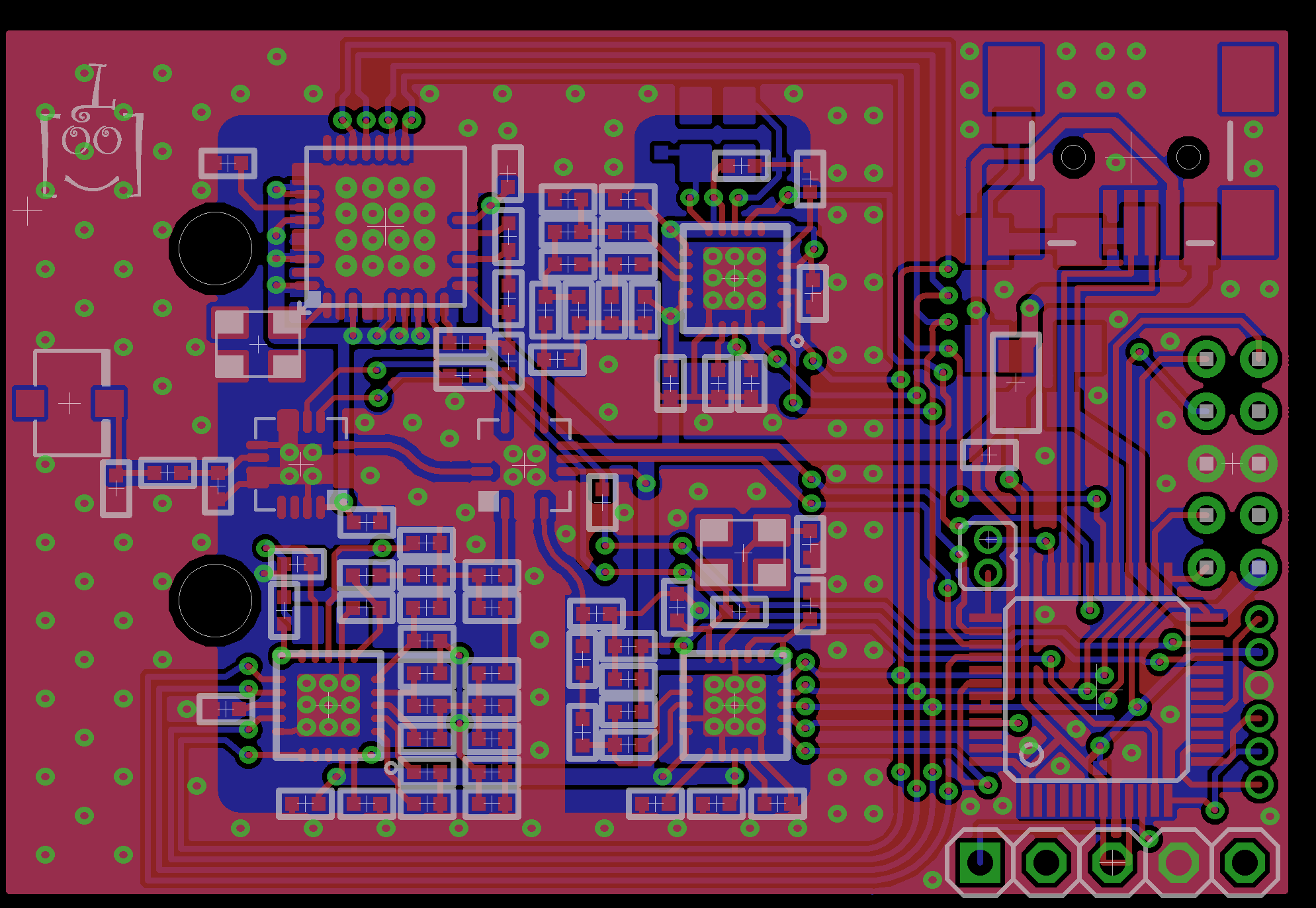

I'm now at the hard part. I've got the RF fully routed (though it may need some tweaking/component adjustment) and just need to complete the digital section. Trying to squeeze the routing into the available space is proving difficult and I'm not having great success. I could go to a 4 layer board and solve the issue, but I don't think it should be necessary. I know there are some folks here who do layout, so maybe someone will take a crack at it. Otherwise I'll keep plodding along on it.
Here are the eagle files for the circuit as things are. The only placement critical stuff (not in the RF section) is the 1x5header on the left and the 2x5 header in the bottom middle. Anything else is fair game. Also, most pins on the STM32 can be rearranged/reordered to improve congestion. The power pins need to be able to handle 500mA, so wide metal will be needed out of the LD1117. the LD1117 should really remain on the top of the board if possible. Design is being done to OshPark rules, though I'm sticking to 8mil traces where possible (dru file is included).
Anyhow, I'm taking a break for a little while. Feel free to have at it if you have the inclination, time, and skill.
BTW, I am working with some folks who have RF design experience who can possibly bring this to market (and will likely end up doing their own layout of the board). However, I have no commitment that will come to pass, so doing the design myself is a hedge against that progress.
Edit: Removed old version. See below

Well, I couldn't leave it at that. So here is the fully routed board:
There is still a lot of optimization to do (as well as the RF matching). I also need to re-verify the schematic since I moved everything around. Still, I'm glad I was able to get it all done in 2 layers.
Edit: See below for updated eagle files with the brd file

Impressive work as always. I really don't know how you do it, you surely are one of those persons (unlike me) that don't need much sleep.

The zip file does not have a .brd, so I could not enjoy it in full. Otherwise, it's impressive routing work.
