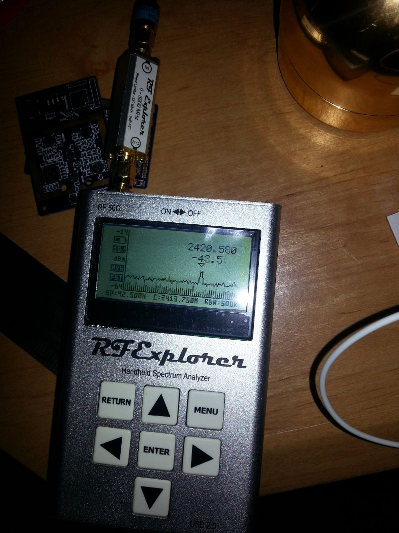

05 Oct 2014 02:15 #25951
Replied by PhracturedBlue on topic Single-Board Universal Module
I was able to add the 100pF cap to the board as well. It really wasn't too difficult.
I have checked in my latest code which adds a test-mode for the RF modules.
There is good and bad news.
The good news is that I seem to be able to send a signal out of the module:
The down-side is that the signal strength is very weak. it is about 13dBm down from the BUYCHINA cyrf module I have at the same settings. Note that you should ignore the absolute number, I don't have the calibration right for the attenuators I have installed.
I haven't done any debug yet other than to verify the same code works on the Discovery board. It is possible I have some settings wrong. I also haven't gone through and tested all 4 modules yet. But getting any signal at all out is a good start.

06 Oct 2014 00:09 - 07 Oct 2014 02:46 #25956
Well, I cycled through the 4 transceivers.
CYRF: -41dBm @ 54mA
A7105: -31.5dBm @ 54mA
CC2500: -48dBm @ 73mA
NRF24L01+: no signal @ 33mA
At full power, I would expect the current to be ~400mA, so I think we're nowhere near max power. I need to check that the stm32 I/O is working as expected. Something definitely looks fishy here.
CYRF: -41dBm @ 54mA
Last edit: 07 Oct 2014 02:46 by PhracturedBlue.

06 Oct 2014 00:21 #25957
by mikemacwillie
Replied by mikemacwillie on topic Single-Board Universal Module
That does seem quite a bit low. Unfortunately the RFAxis datasheet is pretty light on test data. I wonder if it's getting lost at the switch?
I placed an order for an RF explorer today (Been on the fence for quite a while), so I'll be able to duplicate some testing in a couple weeks.
06 Oct 2014 01:58 #25958
Note that you'll need the following:
* U.FL to SMA connector
* DC-Block SMA connector (I use this as it also has a 6dB attenuator and power limiter: 'Power Limiter for RF Explorer', but you can find similar items on Ebay)
* 30dB attenuator (I found one on Ebay searching for 'DC-3 Ghz 30dB SMA attenuator')
* sma cables and adapters to connect the RFExplorer to the board.
You can also use antenna on both sides, but this can be tricky if there is any wifi or bluetooth in the area since you'll get a lot of interference.
