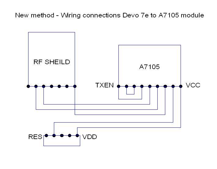

- Newman
- Posts: 47
21 Apr 2015 01:10 #31444
by Newman
Replied by Newman on topic A7105 wiring of GIO pins
I am using Deviation 4.0.1 with a A7105 wired the "new power saving way" as per attached image, Is it necessary to use the nightly build to optimise this connection method i.e. lower power consumption and some telemetry support IIRC. Seeing as the nightly built is, I am led to believe not as stable as 4.0.1, is there any problem with using the new wiring with 4.0.1. which is what I am currently doing and it is binding to Hubsan with no apparent issues. Thanks Pedro
- Orion55
30 Apr 2015 12:20 - 30 Apr 2015 19:13 #31848
by Orion55
Replied by Orion55 on topic A7105 wiring of GIO pins
Hi
I have added the connections for the NRF24L01 module as well
Last edit: 30 Apr 2015 19:13 by Orion55.
30 Apr 2015 14:52 #31852
Replied by Deal57 on topic A7105 wiring of GIO pins
Where you show the NRF24L01 ground pin 1 going to the Devo 7e position 4 next to Vdd on the 7e board, that connection may not always work. I found the most reliable connection for ground for both the NRF and A7105 was the ground pin on the CYRF RF Shield pin 7. YMMV, but I think we see a lot of cases where the position 4 was used and had problems.
- Orion55
30 Apr 2015 19:19 - 30 Apr 2015 19:27 #31858
by Orion55
Thanks for the heads up on the GND position
I have changed the diagram above as you suggest
Presently using my devo7e with
WLtoys V911 Pro
Hubsan X4 H107L
Syma X5C-1
WLtoys V911 Pro
Hubsan X4 H107L
Syma X5C-1
Last edit: 30 Apr 2015 19:27 by Orion55.
- Newman
- Posts: 47
27 Aug 2015 02:19 #37229
by Newman
Orion55 - thanks for adding the NRF24L01 module to my diagram, nice job
Sorry for the late reply I thought that I had already thanked you
