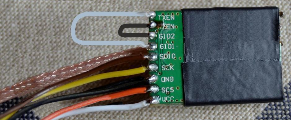

I attached two files that I think show the way an XL7105 module is suppose to be wired if using the nightly downloads or any Deviation 4.0.1 or newer. What I'm looking for is verification that it right. And I hope that whoever created these files won't be upset by my modifying them.
Tim
Tim
Last edit: 06 Jul 2014 00:18 by TimChiaretto. Reason: Mispellings

06 Jul 2014 13:42 #24417
Replied by PhracturedBlue on topic A7105 wiring of GIO pins
Tim, your image is correct.
These are the same instructions I provide in the current documentation here:
bitbucket.org/PhracturedBlue/deviation/wiki/ModuleList
Dan is also correct in that this is only for the nightly builds. 4.0.1 must use the old wiring where TX_EN and RX_EN are tied off.

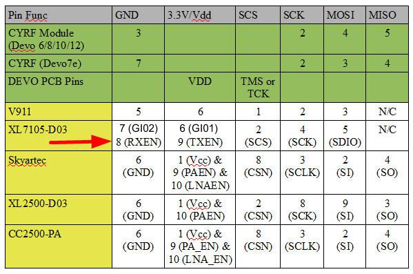

Replied by Waterbound on topic XL-A7105-D03 - Confused about wiring
Hi guys, I am running devo7e-v4.0.1-dd446f70 nightly and having issues getting the XL-a7105-d03 working.
I am confused as I see a few different wiring diagrams published, so I am unclear if I have wired correctly.
On this page, it indicates "*4.0.1 and earlier: Connect 8->GND and 9->3.3V. Leave 6 and 7 floating " (what does floating mean?)
Does this mean RXEN (
gets connected to GND (3) and VCC (1) and TXEN (9) get connected together?
On the same page listed above it says "Connect 6->9 and 7->8 (*)"
So according to that do I connect 6-9 and 7-8?
Which is correct? Do I keep the loops between 6-9 and 7-8 as well as connect 8 to GND and 9 to 1?
Thanks!
Currently I have it wired like this and its not finding the module, edited hardware.ini and checked everything with dmm etc:
4.bp.blogspot.com/-xkOUPc1CsSA/VQBfn72G_...w/s1600/A7105-7E.jpg
Thanks!

11 Apr 2015 21:42 #31059
by aMax
Replied by aMax on topic XL-A7105-D03 - Confused about wiring
...for nightly builds..
www.deviationtx.com/forum/6-general-disc...0-for-frsky-rx#28027

11 Apr 2015 22:04 #31061
by Durete
Replied by Durete on topic A7105 wiring of GIO pins
I agree with aMax.
For nightly builds, much better the new style wiring (AKA 6-9, 7-8 bridges).
Low power consumption when not in use the A7105 module, and don't loose Telemetry under supported protocols (Hubsan protocol for ex.)

12 Apr 2015 13:36 #31101
by Waterbound
Replied by Waterbound on topic A7105 wiring of GIO pins
okay so I'm close, I also see SCK wired to ground, is that correct?
as far as wiring to the TX board (adding the loops back and grounding SCK, the Rx side is the same as this ?
thanks so much for your help guys! I have the NRF module working great, just want to get this a7105 working now
- Durete
- Posts: 610
12 Apr 2015 14:32 - 12 Apr 2015 14:33 #31104
by Durete
No, SCK don't need to be wired to ground.
Your schematic at your first post is OK. You only need to change the bridges for RXEN and TXEN.
TXEN to GIO1(6 - 9) and RXEN to GIO2 (7 - 8 ), and be sure you configure your module at Hardware.ini to point TMS signal (a13)
Last edit: 12 Apr 2015 14:33 by Durete.
