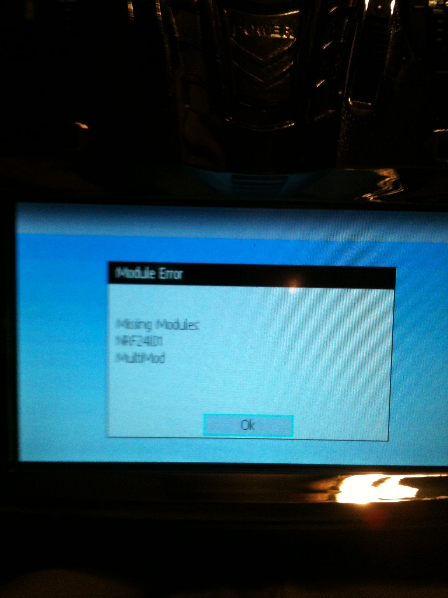

I have recently discovered the nightly builds does not support the NRF module when installed in the Devo12 and would like some of pros to please take a look at it and see what is wrong with it...The nightly works with the NRF module fine in my devo8 but when installing the same module in my 12 it says "missing module" I rolled back to Deviation 4.0.1 firmware on my 12 and the module works fine so i know there is no issues with the connections to the devo12 ..it has to be something in the nightly builds firmware...not sure if anybody else has experienced this and resolved it but would love to know how to fix this issue...

Still says same thing when i enable the NRF module in the hardware file...

I actually have it commented out at this time and still says missing module so yes it doesn't seem to bother the NRF module...all i know is it is really weird that the nightly works perfect on my 8 with the NRF and no matter what i try it will mot work on my 12..
the module works with deviation 4.0.1 non-nightly build but my cx-10 flies weird compared to the nightly on my devo8 ...its a bit jerky on the controls where as on the 8 it is really smooth running the nightly build..

Already checked it...3.3v at the vcc on the module pad..seems if it were a power issue the module would not work with deviation 4.0.1 and not work with the nightly..it really has me confused cause everything is hooked up correctly and i have double and triple checked multiple times with a voltmeter..
