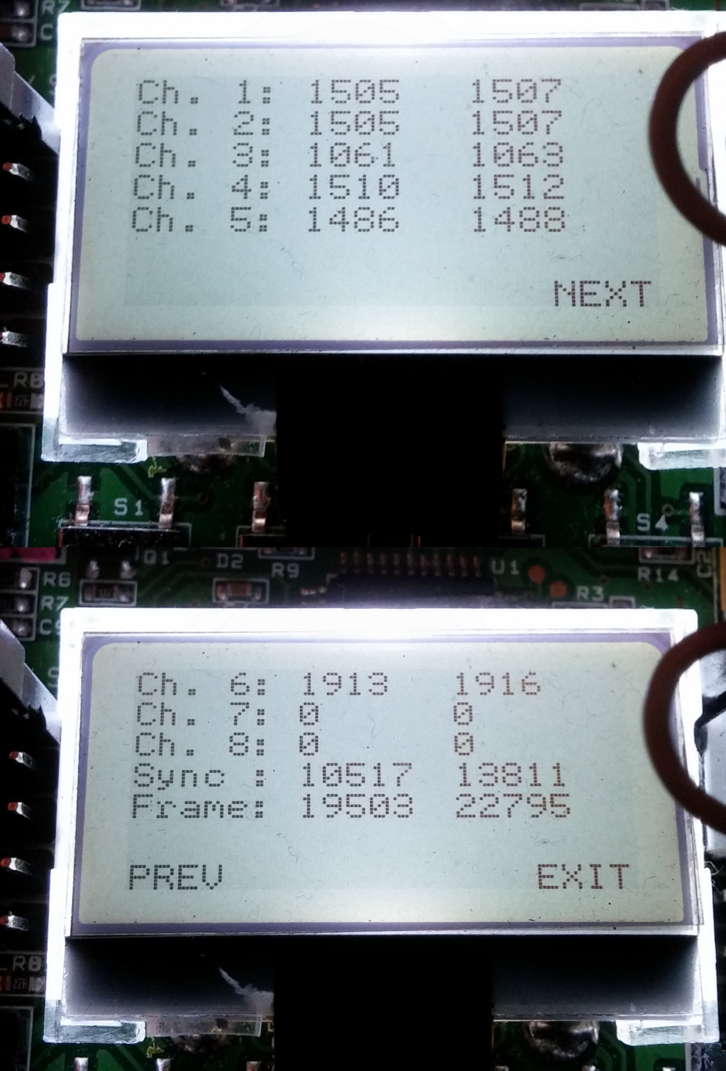

28 Jan 2015 17:47 - 28 Jan 2015 18:04 #28171 by Arakon
Replied by Arakon on topic Devo10 DSMX and Oranage/Lemon Rx issues
I just tried www.deviationtx.com/forum/3-feedback-que...y-questions?start=40 this version where Telemetry can be turned off. No change. Flickers, rotates left, lots of frame and synch drops. Plug in the DSMX or DSM2 sat and it instantly flies fine again, no flickering there either.
To sum it up:
- Spektrum Satellites (both OrangeRX and Lemon) give me no flickering. On KK board, the Orange ones sometimes trigger signal loss (rarely), but never actually lose control.
- Spektrum PWM receivers (LemonRX 6 channel "Feather light") no flickering, no issues at all.
- Spektrum SBUS receiver (3 Channel DSMX, OrangeRX) never flickers, never loses signal.
- Spektrum CPPM receivers (OrangeRX R410X and R415X) keep flickering, show bad frame and synch drops, cause the KK board to yaw constantly.
These are the high/low values of the data the KK board reads from the CPPM receiver over a course of roughly 10 minutes. You can see that the frame and synch values drop very far.
What I can not test is how it behaves with an original Spektrum Transmitter.
Last edit: 28 Jan 2015 18:04 by Arakon.
