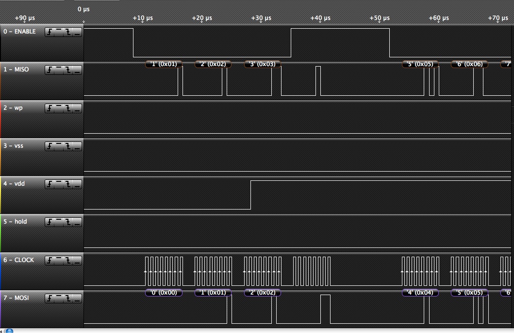

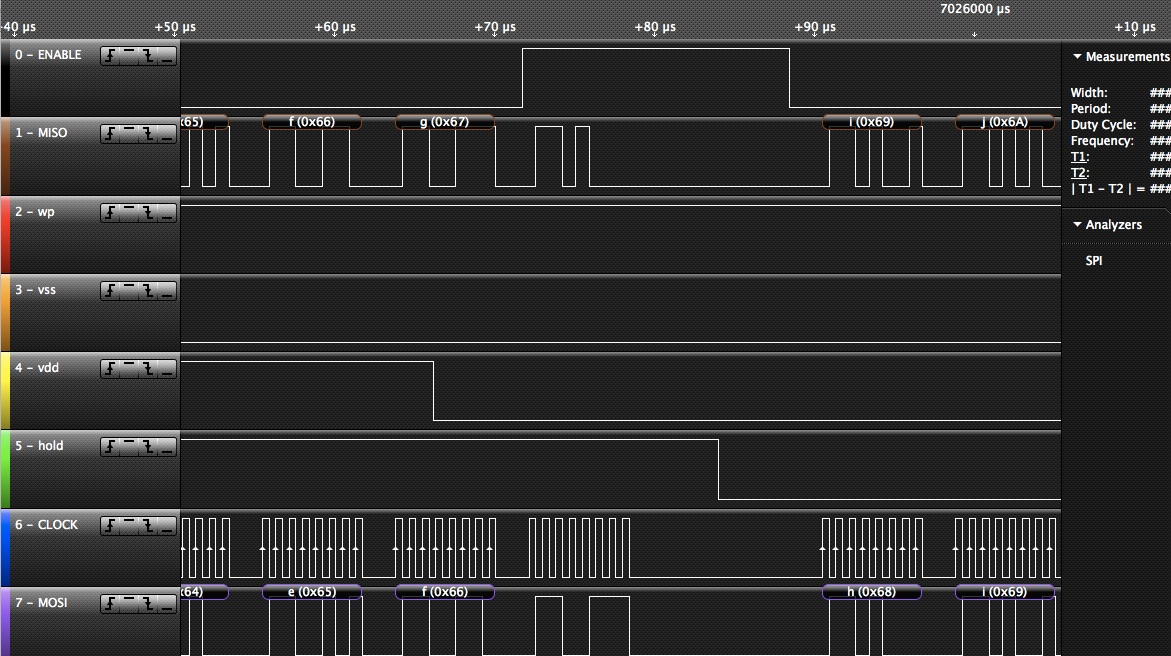

21 Apr 2015 22:42 - 21 Apr 2015 22:46 #31475
by djtrance
Replied by djtrance on topic Can Any help me with my F7
PB,
after that I use the saleae logic I think the memory is working how you can see in the image. but I don't know if is working how must to do, because, when I change some information on the model in the original firmware, and after this I turn off the radio, when I turn it on.. the radio haven't the change that I did. for this reason I will try it with the deviation firmware for f7 but I must be sure that the dfu firmware will not erase the original boot loader. How I can be sure that will not happen?.
the makefile has :
DFU_ARGS := -c 7 -b 0x08003000
the first image is when I turn on the radio, the secos is when I turn off the radio
the makefile has :
Last edit: 21 Apr 2015 22:46 by djtrance.
22 Apr 2015 00:45 #31477
Replied by PhracturedBlue on topic Can Any help me with my F7
The deviation bootloader has code to prevent writing to the bootloader memory region. I have never overwritten the bootloader in all the testing I've ever done. If you have a STLink, you can restore the bootloader (I have the f7 bootloader if you need it) in an emergency.
To boot your code, you need to ensure you leave a hole at 0x 08005000 because the dfu code installs a checksum there. if you use the deviation devo7e.ld file, you should be ok.
I don't understand your Saleae logs. I would not ever expect to see clock with vdd low. I also didn't think that the hold or wp pins were even used on the Devo radio. I would expect them to be tied directly to Vdd. The CE transition doesn't make much sense with respect to the data I see either. So I can't help you with the logs you've provdided

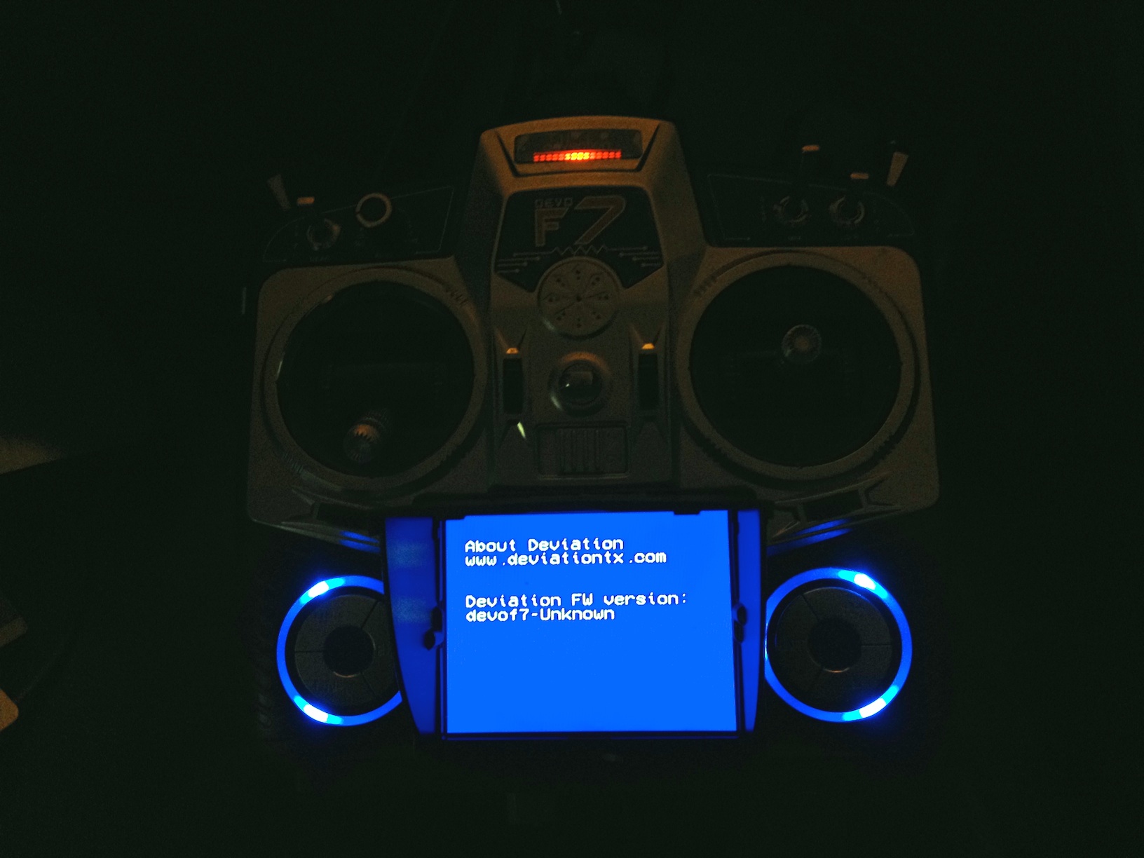

22 Apr 2015 03:44 #31485
by djtrance
PB, I can write to the memory, (the wrote memory now, has the file system, the model and the protocol folder), I tested with devo protocol and it's working. now I will search for more information about the OSD chip, because would be interesting If I can write pixels, because without this, must be a hard job to change some things.
I have the MicroUAV code now. I think that is a Deviation 4.0.0 code. How you think is better to start?
