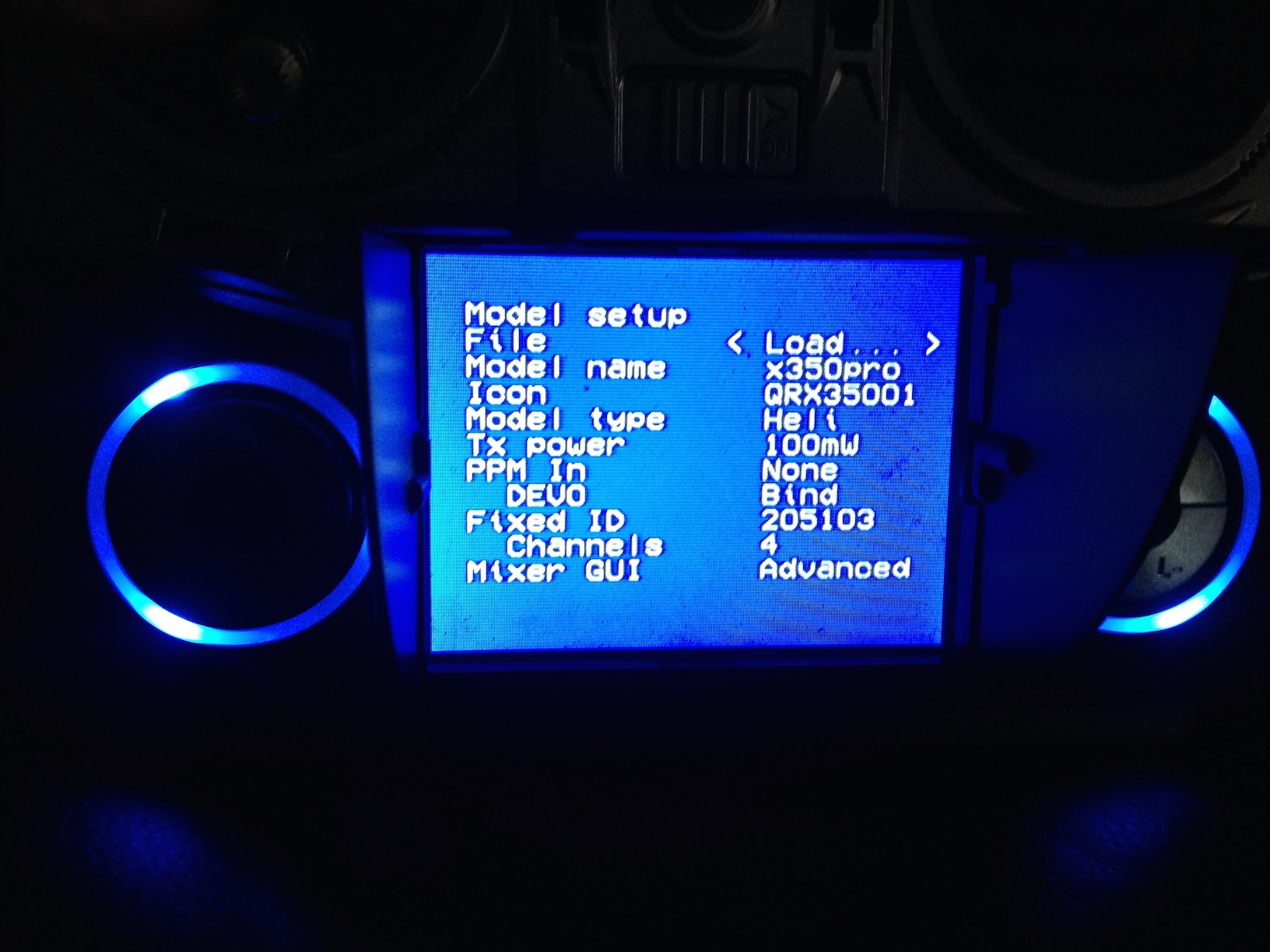

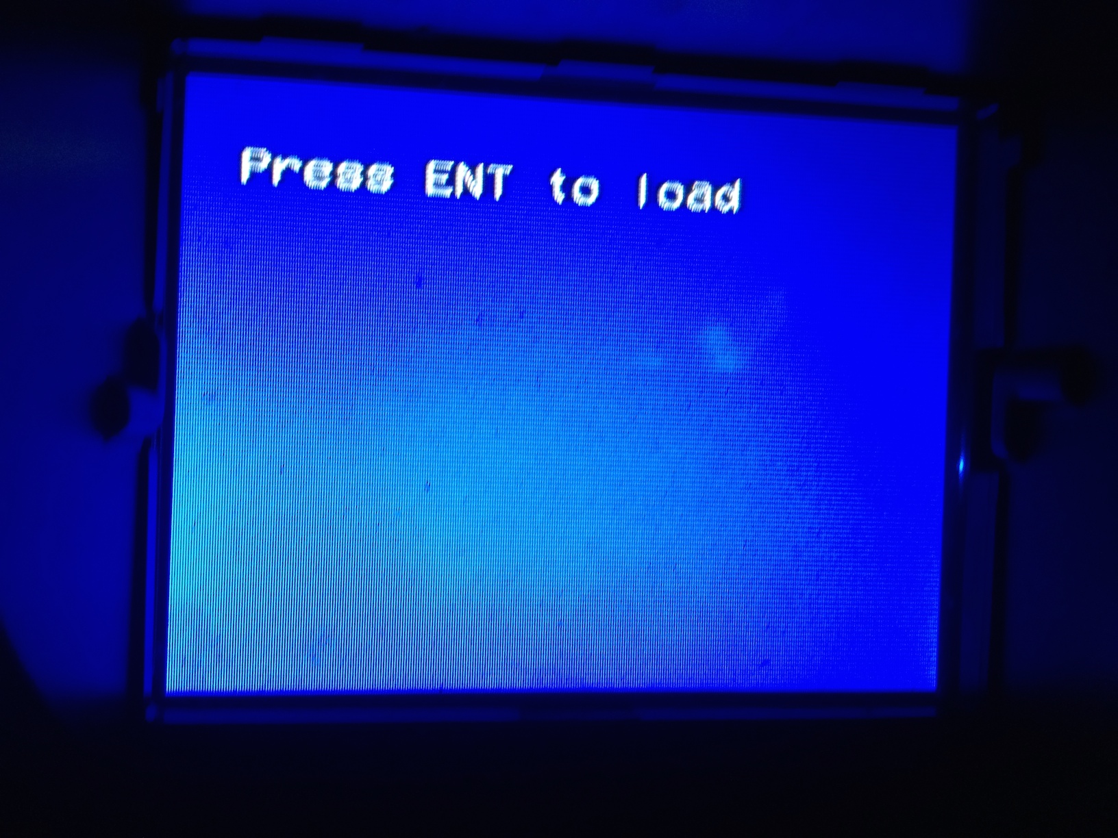

Wehn I try to load a config, the screen only show "press net to load"
28 Apr 2015 22:26 - 28 Apr 2015 23:24 #31760
Replied by PhracturedBlue on topic Can Any help me with my F7
That is a lot better than I expected.
The arrow indicator that I use in the emu is not properly mapped in the F7. I'll fix that next
The listbox is not supported which is why you can't load any models. Generally there is a lot of work still to do to get the code working fully. Listboxes are next on my list though.
Don't get your hopes up too much though. As soon as I have the basic GUI code working, I'm going to switch my effort to the F12E.

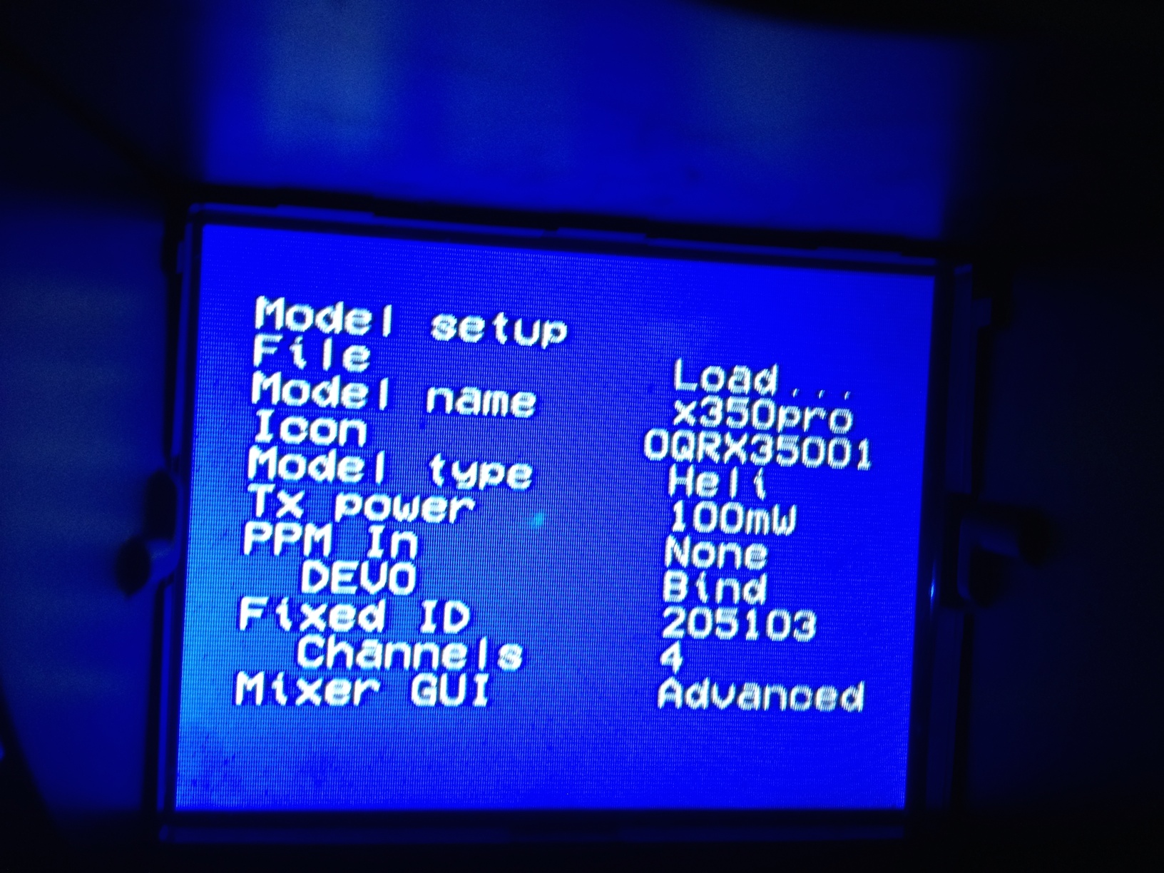

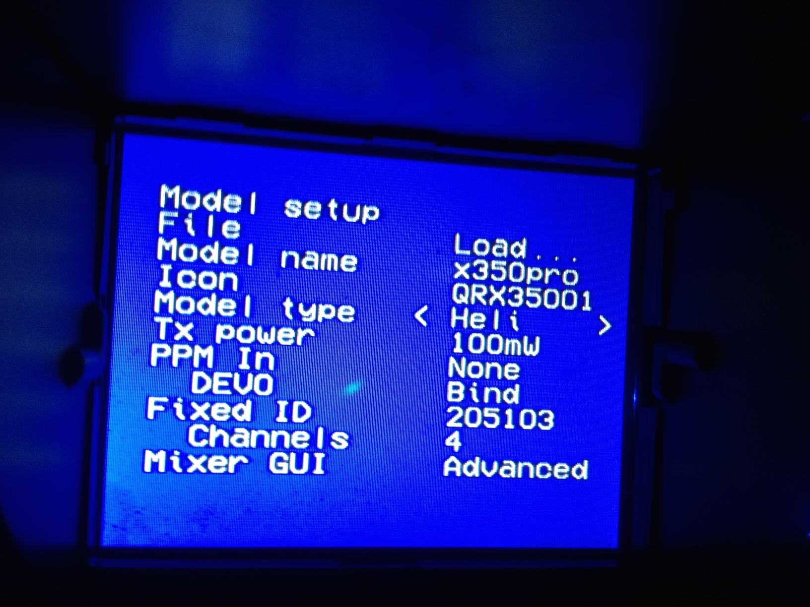

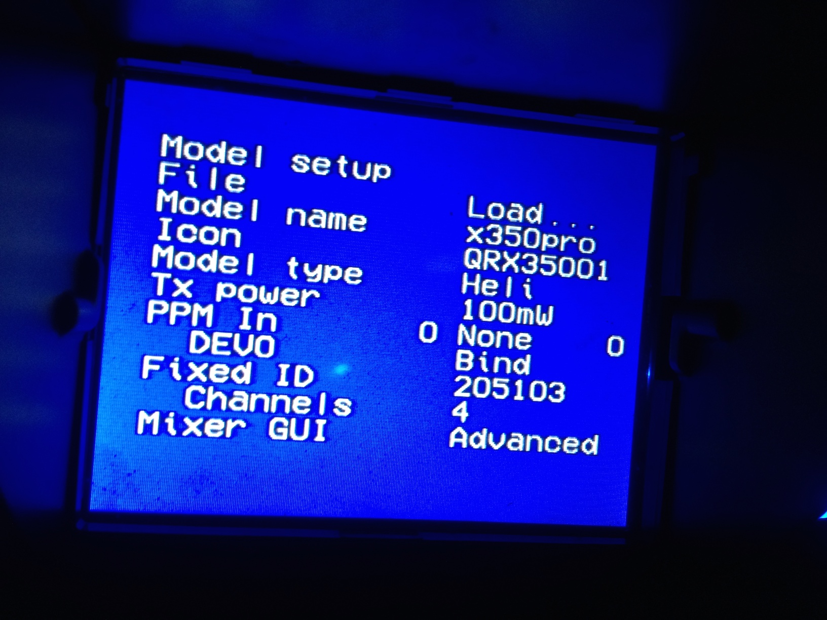

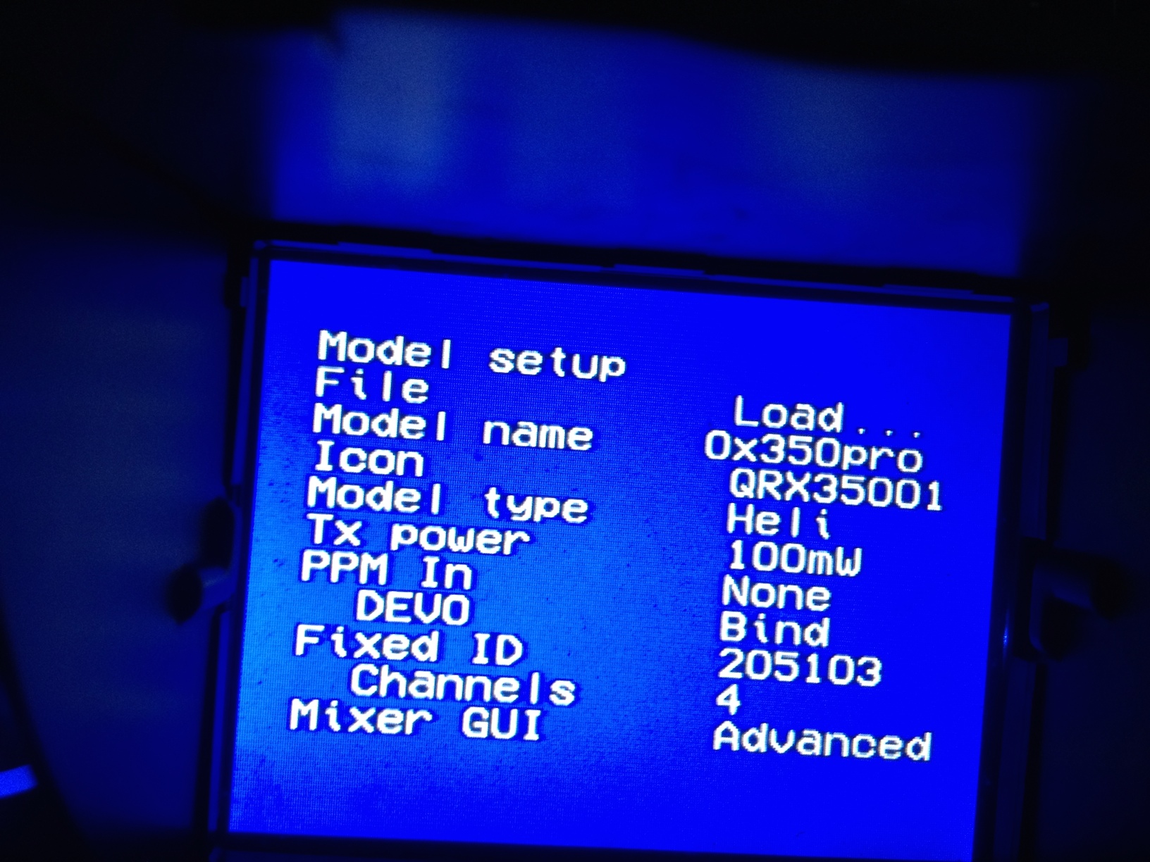

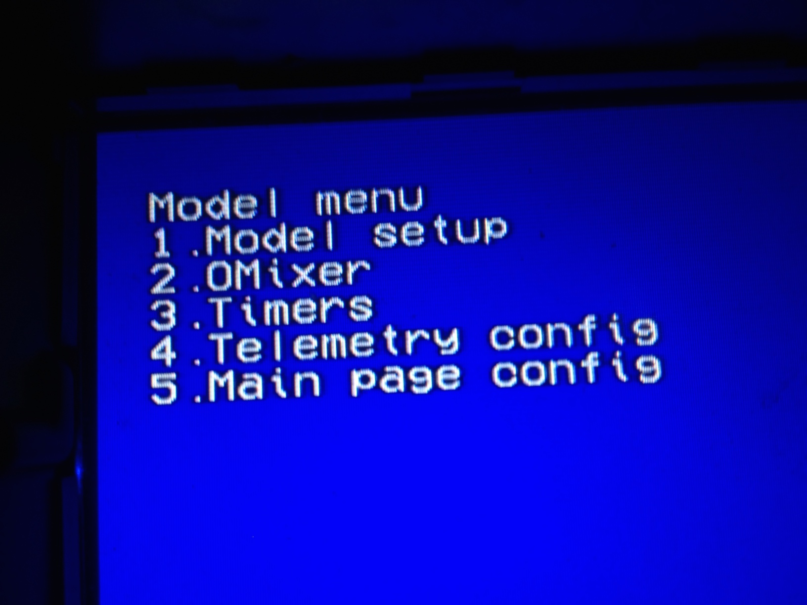

I checked in an update that enables the keyboard display.
It also should properly give you the arrow characters instead of 'O'
I'll look at the listbox next

PB, you are amazing, I'm still learning how the gui is working. I know how to write on the screen, but I must write the code in the same way that your code.

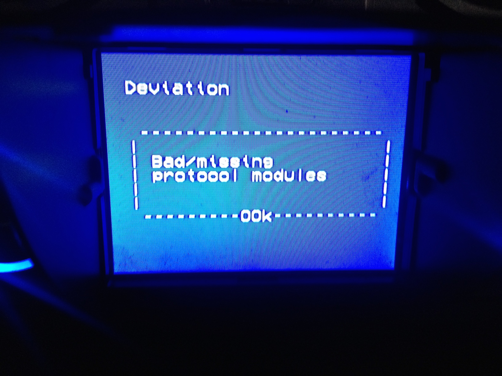

PB, I'm testing the last code, but there are something wrong, the devo can't turn on, only show a full screen in blue and the sound in loop.

make sure you have errors.txt on the filesystem and that it has at least 1 byte in it (open it and add some text if it is empty)
then after the reboot, send it to me along with the devof7.elf file (that is in the build directory) Make sure the devof7.elf came from the same build as your dfu

then flash back a previous build.
save your devof7.elf file somewhere, then install 0af95bee8f97 (or earlier) so you can get tothe menu.
Since my f7 doesn't have the larger Flash, I can't duplicate the issue.

the crash is happening within the protocol code. My guess is it is related to the display caused by the dialog box, but I really don't know. can you do the following:
install the busted dfu
hold 'ENT' while booting
wait for boot loop (keep holding 'ENT')
switch off tx (while still holding 'ENT')
once it is off, put the 'good' dfu back on and send me the errors.txt
That should get me a stack dump that has nothing to do with the protocol code (which is really hard to debug on the f7/7e)

When I did this step, the screen on devo it say deviation USB.
You can see the file in the same folder, the name is error2.txt
I don't see differences on this files.

1st grab the latest code I just uploaded. It won't fix the crash, but it should fix the screen color.
now try removing all of the .mod files from your tx and try again.
if it reboots, you can just hold 'ENT' to get to the usb menu and grab the errors.txt (no need to put the 'good' dfu on
I will need your devof7.elf though since you need to rebuild with the latest code.
I do not need any of the files currently on the dropbox so you can remove/replace those.
I just pulled out my F7 and I can get to the USB page via 'ENT' so the issue isn't with the font mapping. that implies it may be the dialog box. After creating the errors.txt as above, you could try each revision in the commit history and find the last one that works for you.

try the latest checked in code.
same procedure if it fails.
the problem appears to be related to module loading and not to any changes I've made. Another thing you can do is to make sure you copy the latest mod files to the protocol dir every time you upgrade the dfu

The problem es that I must change the protocol dir before to turn on the devo.
what I do?
1.- change the firmware.
2.- turn on the radio -> (the same problem)
3.- push the ENT -> (usb mode)
4.- I put the new protocol folder and restart.
5.- the radio can turn on.
Now I must go to sleep.
I'm not sure but, I think that now I know how to do the bar for the trim

the reboot shouldn't happen. That is definitely a bug (but it'll likely also be an issue on the 7e too).
The process is always:
upgrade dfu
power on with ENT pressed
copy filesystem
power off
power on as normal
