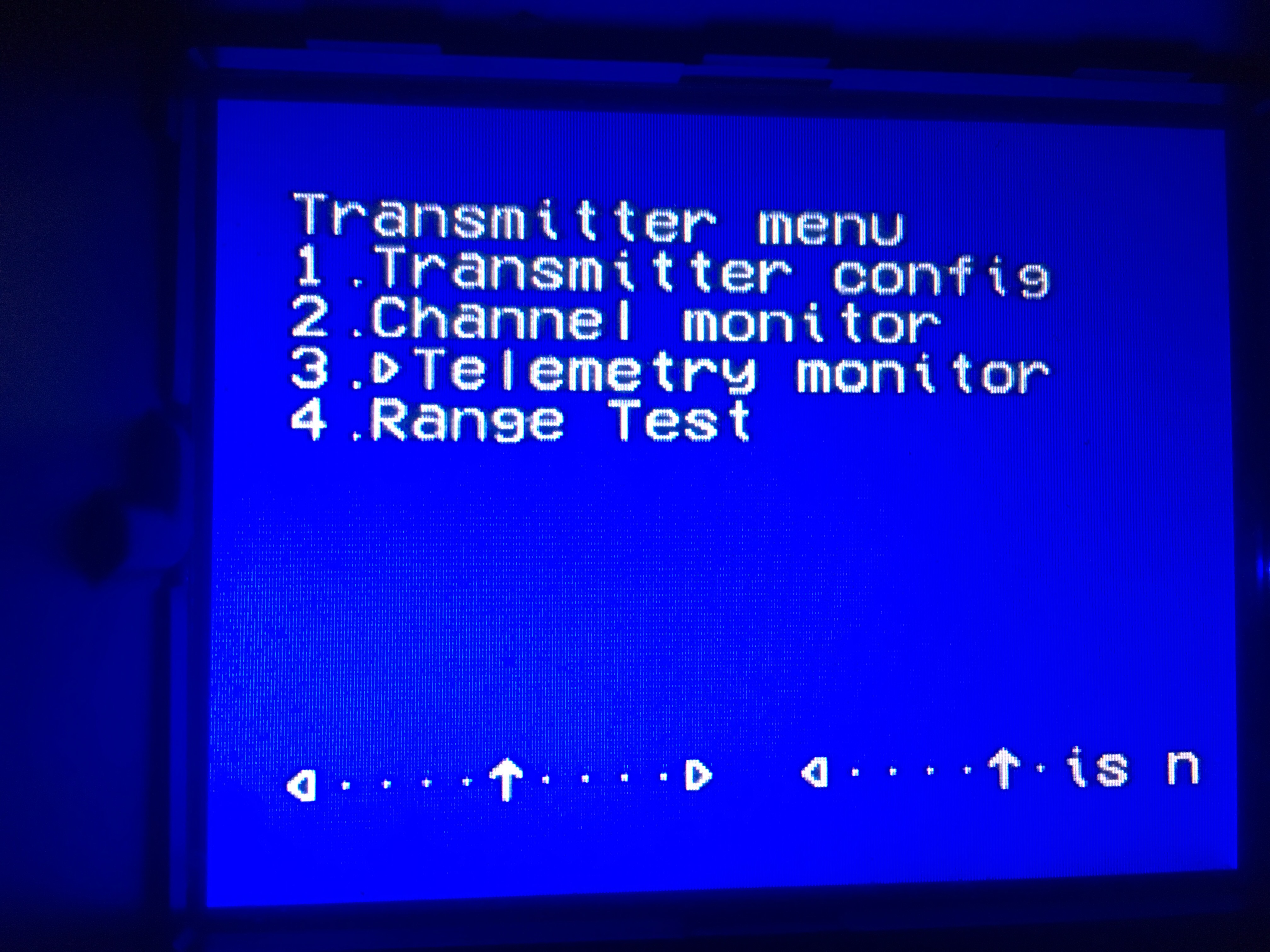

This is the problem
10 Apr 2017 10:10 - 12 Apr 2017 04:10 #61334
Replied by vlad_vy on topic Deviation for Devo F4?
With devof7 emulator I never get something like this.
It looks like code for real devof7 has wrong screen dimensions:
src/target/devof7/lcd.c
but
src/target/devof7/target_defs.h
Can you test build with fixed LCD_SCREEN_LINES?
File deleted...
// The screen dimensions
#define LCD_SCREEN_LINES 11
#define LCD_SCREEN_CHARS 24but
#define LCD_WIDTH 24
#define LCD_HEIGHT 12Can you test build with fixed LCD_SCREEN_LINES?
File deleted...
Last edit: 12 Apr 2017 04:10 by vlad_vy.
