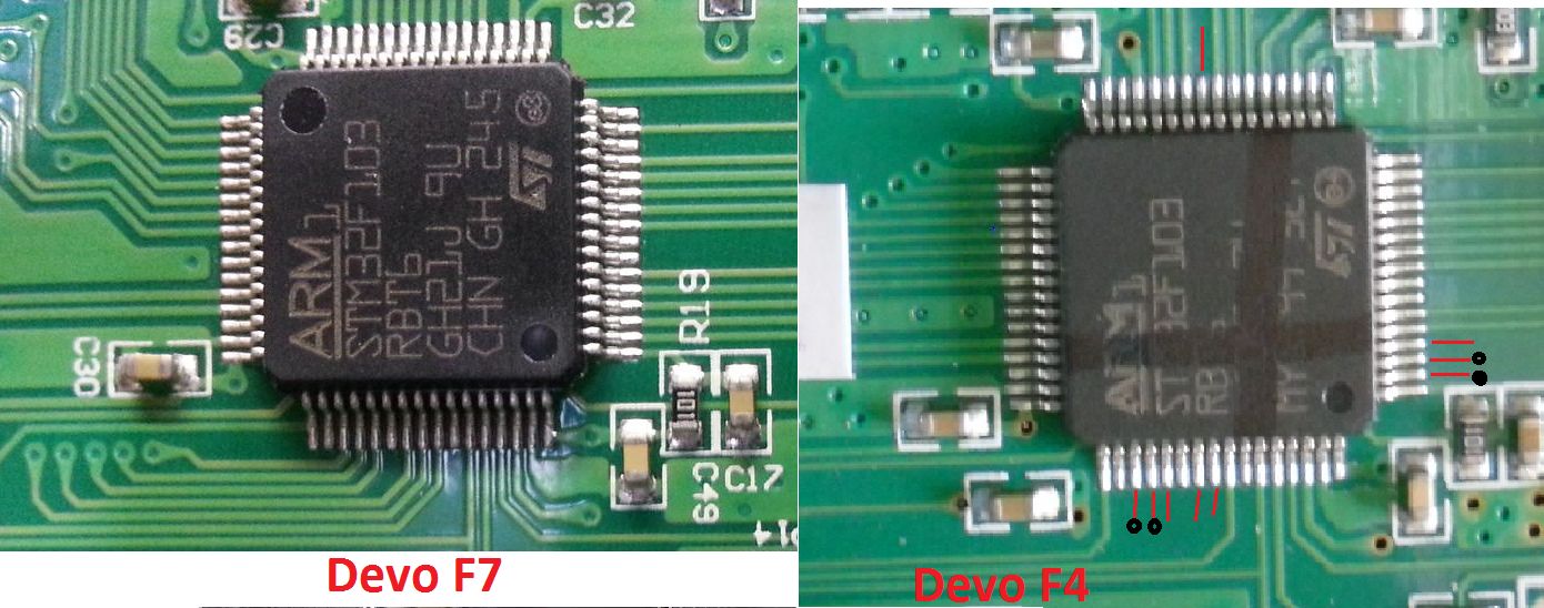

You can install an nRF24L01, but you can only use a couple of protocols at a time.
You want to change the protocol you have to update the radio by creating the devo.fs file with the two or three protocols that interest you. There is not enough space for more than 3 or 4 protocols (depends on the protocol size).
You can replace the memory chips so you'll have room for all protocols but you have to be good otherwise you will irreparably damage your card.
This is what you can do! But is it convenient? For me no!
The transmitter is limited by its only 4 channels.
For a serious drone, you need at least 5 channels!
Until someone finds the way to add at least one channel, it's not worth investing in this transmitter.
In my opinion it would be very easy and fast to add channels by activating them in the firmware but programmers do not seem interested in releasing a firmware with this possibility.
The Devo F4 processor is identical to that of the F7 that has multiple channels.
The processor pins in the F7 are used for the 3 additional channels and for switches are unused in F4.
You should just enable these channels in the F4 firmware. Everyone could add potentiometers through the processor pins.
In the attached picture you can see what I explained.

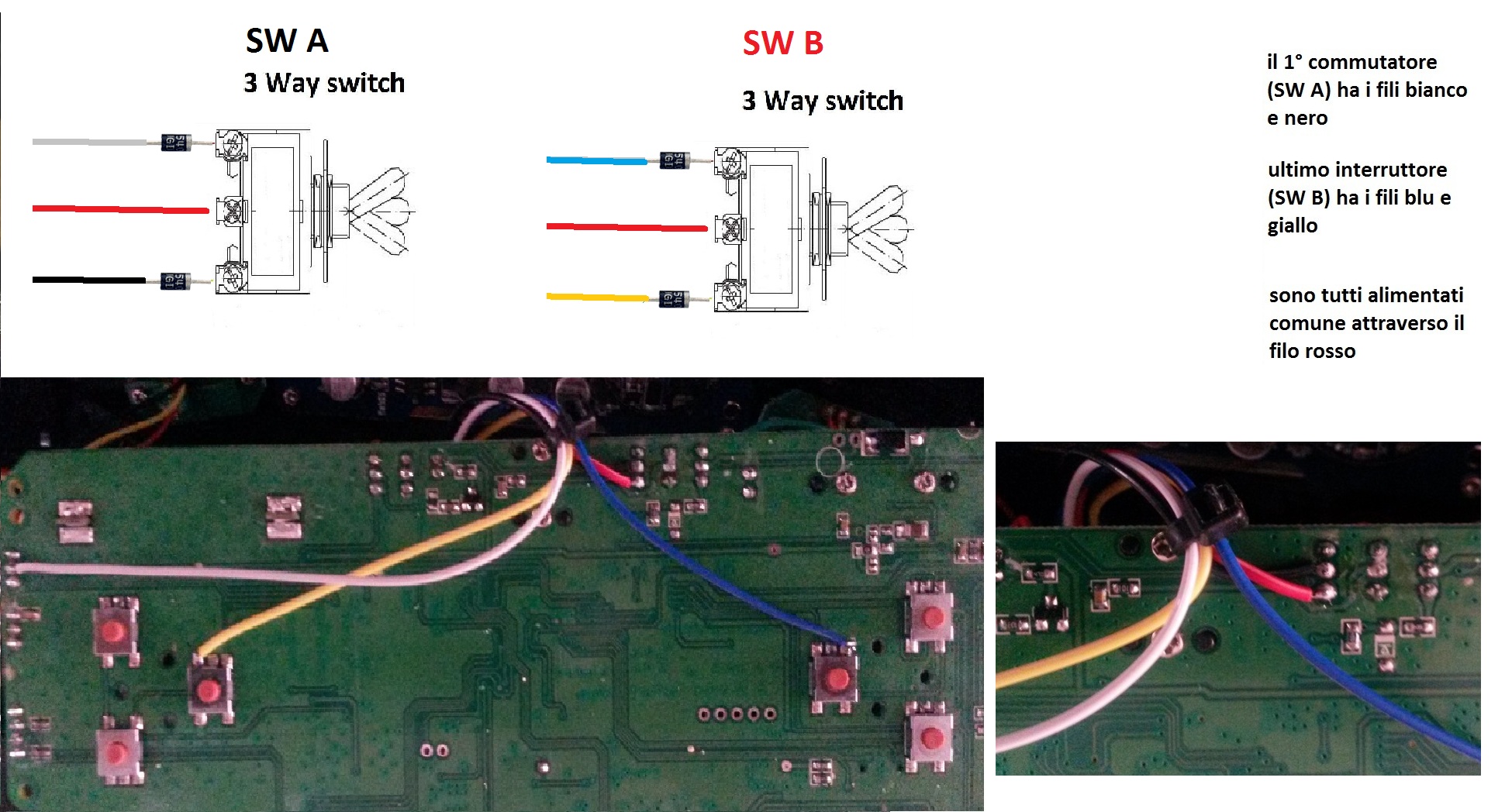

First of all, LucaG is messing up channels and inputs, I tried to explain it to him but seems like I failed somehow
Of course, Deviation has all channels the protocol supports. You just lack switches (I don't think there are much more analog inputs needed, of course one can feed them in using an arduino and the trainer port via ppm). Also, you can set up every single trim switch to act as a virtual switch, which can be used to toggle a channel high or low (e.g. switch for acro/level mode, rates, arm switch, whatever)
I figured out also a 2 3way switch mod. Link in the wiki for DevoF4. You may scroll through the pages to see what we did with our F4s.
Btw, devo.fs seems to be a little less stable, at least in my case, some model file details got lost, but most likely only if changing trims. After reboot, devo.fs might be corrupted. If you don't chane anything in,your model files, you're fine in my experience. Another way is to replace the flash memory. Not that hard, I didn't do it yet but should work fine. It's a replacement of a 'bug' with 8 legs.

3. The switches you can add are those you see in the pictures I attach!
Warning: I asked to confirm the diagrams I developed by reading the post but nobody could confirm me with certainty that they are correct!
