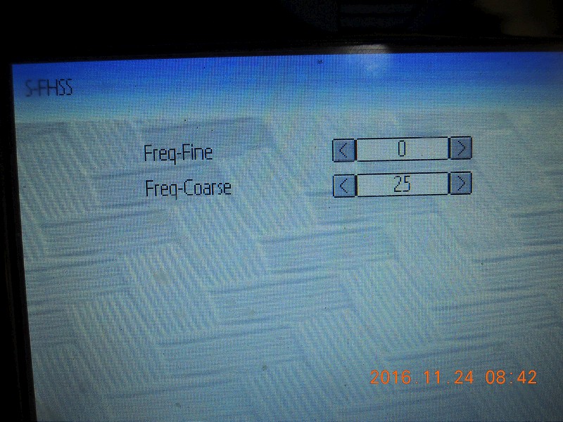

23 Nov 2016 23:10 - 24 Nov 2016 01:25 #56240 by dat
Replied by dat on topic 3in1 / 4in1 RF module
Hi victzh
yes , i have try fine math -127 to +127 with coarse 0 from The fist i begin setup,
i add +5 math up untill +127 , and -5 down to -127 step by btep , many many cycle rounds
just like in forum many people post ,
but it all failed.
when i fell tired that way , ~suddenlly~ , a thought float in my brain ,
try coarse , give it a chance , And ~~ bingo done. ^^
take 2 short video post on youtube
and some pic in here
