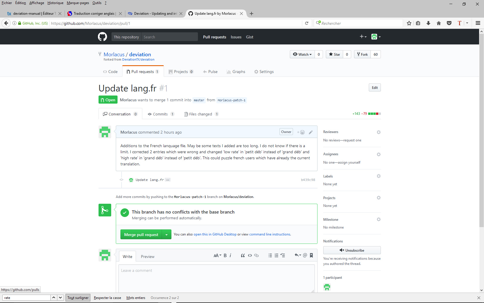

05 May 2017 07:46 #62023
by Morlacus
Thanks for the reply. Once logged in Github what is the way to ask for or propose change ?
Help will be welcome.
Replied by Morlacus on topic Updating and internationalizing documentation
FDR wrote: The language files are in the main repository:
github.com/DeviationTX/deviation/tree/master/src/fs/language
They should be corrected there, so the new builds could contain the changes.Will get the needed changes into them...make language
05 May 2017 08:26 #62024
Replied by FDR on topic Updating and internationalizing documentation
There are more options, the two most common is the following:
- you can edit the content online on GitHub and make a pull request from there;
- fork the deviation-manual repository into your own, make the changes offline, commit them into your fork, and make a pull request from there.
If you plan a serious rewrite, the latter is better, but for small changes you can use the first:
Simply open the source file in the browser, for example like this:
github.com/DeviationTX/deviation-manual/...urce/ch_mainpage.rst
Click on the edit (pencil) icon on the upper right, edit the content, and when finished, select the "Create a new branch for this commit and start a pull request" option below, then press the "Commit changes" button.
While it is possible commit directly into the master branch, even so that is the default option, please don't do that.
This way others may check and approve your changes, or request changes to those before the commit can happen, and this helps to keep it clean and regulated...

Thanks for your reply
I proposed an update of the lang.fr file in a pull request
Hope did correctly.
Hope did correctly.
05 May 2017 14:34 #62033
I don't see it.
Actually I gave you a description about modifying the deviation-manual repository, but of course the main (repository) is the same.
However to see all the new language entries in the lang.fr file, you need to "make languages" in the docker development environment. It will update all the language files, but you can revert all but yours...
- Morlacus
- Posts: 181
05 May 2017 15:08 #62035
by Morlacus
Sorry but I a am just discovering the process which is new for me
I am there (see attachment)
Can you give me more info on docker environment ?
