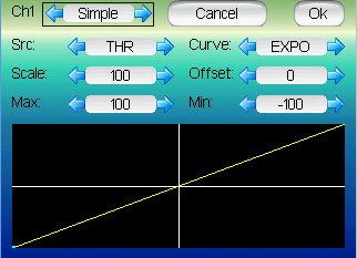

10 Jul 2012 18:15 - 10 Jul 2012 18:18 #463 by PhracturedBlue
Replied by PhracturedBlue on topic Re: GUI
rather than duplicating the bitmaps, I was considering drawing a box around the selected item, but selecting them isn't the part I'm concerned with. It is how the buttons actually work.
Here are 2 options I thought of using the simple-mixer box as an example:
1)
If nothing is selected, left/right change windows as they do today:
pressing 'Ent' or the Up/Down buttons enters select mode:
Now left/right select the widget:
and up/down change the selected widget's value. Ent is the same as clicking the widget
You can't change pages until you press 'Esc' to remove all selection

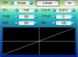

2)
The page starts with the topmost item selected:
If you press the down-arrow again, the next object selects:
Pressing left right will still change the current page at this point (if available for a given screen)
If instead, you press the 'Ent' key, the object either executes (in the case of a simple button like Ok/Cancel) or becomes active:
At this point left/right will operate as the left/right arrows, and 'Ent' will be the same as clicking the button (which is only relevant for the Src and Curve spinboxes)
You cannot change pages until you press 'Esc' to deactivate the widget. 'Esc' will return you to the select mode so that up/down switches the selected widget, and left/right changes page (if available for a given screen)
the weird thing about this option is that you'd use left/right to move up/down on the listbox, which might seem weird.

11 Jul 2012 12:47 - 11 Jul 2012 12:52 #465 by FDR
Replied by FDR on topic Re: GUI
PhracturedBlue wrote: rather than duplicating the bitmaps, I was considering drawing a box around the selected item, but selecting them isn't the part I'm concerned with. It is how the buttons actually work.
Not as nice, but will do, just please let the color be configurable. Or consider drawing a filled rectangle below...
EDIT: I've forgot to add, that the bitmaps could be used for the pressed state too...
PhracturedBlue wrote: Here are 2 options I thought of using the simple-mixer box as an example:
1)
Actually in case of this kind of window (with OK/Cancel) the left/right buttons don't change screen. You have to select OK or Cancel first.
By the way I think it is unusual to use OK and Cancel (especially Cancel) in such applications. Often there is no other way to cancel/undo/rollback changes, than change them back. I like the possibility to play with controls without worrying to change them back, it's just more difficult to handle it with the buttons: you have to go back to ok or cancel and press it. If there is no such buttons, the value changes are prompt, but you can exit the screen any time with one button press (Esc).
Actually I feel bad about vasting the left and right buttons to change screens too. Somehow I miss the entering-the-menu phase...
So basicly I haven't found the holy grail jet...

11 Jul 2012 13:32 #466 by PhracturedBlue
FDR wrote: Not as nice, but will do, just please let the color be configurable. Or consider drawing a filled rectangle below...
As far as using a bitmap vs rectangle, the bitmap is probably not too hard to do, and has the benefit of not taking up more physical space than the current widget. In order to save space, I may decide that they need to be in the same file as the original (so you'd have the original, and then below it the selected one in each bmp).
I'm not sure what you mean by the 'pressed' state. Do you mean for feedback on widgets that take a long-press?
Implementing the 'change color on press' for the keyboard was actually very complicated. I don't really want to implement it for other widgets unless it gives some real benefit. Most widgets immediately react when you press them, so I'm not sure of the benefit of having a pressed state.
We should also, as I think you've mentioned, have an alternate bmp for the 'button+spin-box' widget used in a couple of places. I'm not sure what it should look like, so if you want to, give that some thought.
we could make it so that 'esc' immediately selected (but didn't press) 'ok'. You would then do: 'esc', 'ent' to save changes. We could also just get rid of 'cancel', though I think it may be a useful feature.
using L/R may be a bad idea here, as we may want to create virtual channels using L/R and U/D. One possibility is that 'Ent' would pull up a 'tab' wherein you can use l/r to select the page. There is a risk when using virtual channels though, as you would lose channel control as soon as you pressed 'Ent'.
Also, using a menu to access the different pages probably doesn't actually help the control interface, as it is MUCH easier to iterate through the widgets in the order they were drawn, than to figure out position and move to the nearest above/below/left/right. So in the schemes I proposed yesterday, left/right or up/down really mean prev/next, and i want to keep it that way.
