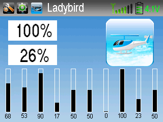

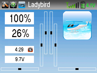

17 Jul 2012 09:01 - 17 Jul 2012 11:43 #548 by FDR
Replied by FDR on topic Re: GUI
OK, Im working on them...
I will post a few variants. Now I have an unfinished one:
It has a header, where the shortcuts are, plus the battery and power info.
The content of the white boxes would be configurable, in this case: throttle, pitch, timer, telemetry voltage...
...and another one:
Last edit: 17 Jul 2012 11:43 by FDR.
17 Jul 2012 14:08 #549 by PhracturedBlue
Replied by PhracturedBlue on topic Re: GUI
Those are both reasonably straight forward but:
* Isnt' the battery bar redundant with the voltage?
* We can't actually use Walkera's images in our library. I need freely available images.
* One of the limitations of the GUI is that you can't draw transparent objects on top of another object (originally we supported this, but it is very slow, so I disabled it). so you can't have transparent bmps or text on top of another bmp. To achieve the header bar we could:
a) embed it into the background. In that case, all screens would have it.
b) use a 2nd background. That is a lot of ROM to spend in my opinion
c) enhance the GUI further to support this. I have a couple of ideas on what we might do, but it is certainly easier if I don't need to.
* I don't have fonts that look like that. It'd would be really helpful if you could work on the fonts. It isn't all that difficult to do, but does take some time.
The program I use is 'GLCD Font Creator'. It is available here:
www.mikroe.com/eng/products/view/683/glcd-font-creator/
You can import any font on your PC to use as a reference, but they generally have too much whitespace on the top, bottom, and left (right doesn't matter, as it gets stripped out. So I import a font as a starting point, and then adjust each character as needed. For larger fonts, I only import the numbers (0-9 % , .) as they take up a lot of space.
Anyhow if you want to give it a shot, it'd be helpful. Otherwise I'll work on the layout with the fonts I currently have for now.
17 Jul 2012 14:42 - 17 Jul 2012 15:00 #550 by FDR
Wow! This was just a concept to show off! :huh:
PhracturedBlue wrote: Those are both reasonably straight forward but:
Bitmaps are easier to receipt. But! It can only give a visual warning about the battery level, however different type of batteries can be used: 1s, 2s or 3s LiPo, 4s NiMh, 4s alkaline, etc. They all have different voltage levels for the bars of the indicator, so the voltage reading is useful. The best solution would be if we could automatically detect the battery type, and set the levels accordingly (or at least to allow to set the battery type).
PhracturedBlue wrote: * We can't actually use Walkera's images in our library. I need freely available images.
OK, don't worry, it's just a mockup! It was quicker to use them, than draw one...
PhracturedBlue wrote: * One of the limitations of the GUI is that you can't draw transparent objects on top of another object (originally we supported this, but it is very slow, so I disabled it). so you can't have transparent bmps or text on top of another bmp. To achieve the header bar we could:
No problem.
IMO the header would be useful on all the other pages too: it could contain the OK/Cancel (or Load/Save/Cancel) buttons, and would separate the page title.
Only difficulty is with those pages, that should be scrollable, because on that the header should remain on top, and only the contents below should scroll...
PhracturedBlue wrote: * I don't have fonts that look like that. It'd would be really helpful if you could work on the fonts. It isn't all that difficult to do, but does take some time.
The font usage is not intentional. I've just used what was selected. No significance...
The question was: how do you like the concept?
There could be some more such templates to choose from, and some elements of the templates would be configurable...
EDIT: For example you could change between these main screen layouts with the left/right buttons, but the default layout for the model should be configured in the model data...
Last edit: 17 Jul 2012 15:00 by FDR.

I think yes, it is good indeed. I have only some minor complaints about it, most of them are about the menu structure inherited from the 2801. They splitted the functions into model, function and system menu, but they are sometimes in the wrong place, and the separation makes it too complicated to navigate between them.
Furthermore, don't forget, that all our users will come to the deviation fw from the walkera one. It doesn't hurt, if it is something familiar. Makes the learning curve easier...
PhracturedBlue wrote: I'm also not sure about the shortcut bottons at the top. I think they'd be too small to easily use via touch, and we won't allow button selection with the physical buttons on the main screen (I like your idea of using a long-enter press to enter the menu from the main screen). I owuldn't want to make them much bigfger as they'll strat interfering with the Model name. We would still need a way to get to the menu via the touch-screen, but perhaps a better option would be a single button which could be larger, or even any press on the top-bar.
If you like the long enter for the menu, than it is good enough...
I have placed three buttons on the header, but we might not need all of them. Even in the original fw you can click on the model name to select a model, and on the picture itself to edit the model (plus on the power indicator to edit the power amplifier, etc), so we will have enough large areas to click on, and the rest of the header could be all entering the menu...
PhracturedBlue wrote: I'm still not convinced about the battery indicator. Don't most folks get 10hrs or so out of a transmitter charge? In which case how often do you care about the transmitter voltage that you need to be able to read it at a glance? I think either text or bitmap, but not both will be sufficient, but it isn't exactly the most important topic.
OK, it's not that important for me either!
If I have to choose, I think the text is more important.
