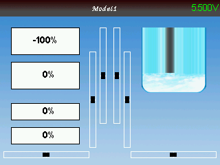

I have some bug with the model picture on the main sreen too:
that is weird. is it with the bmps I placed or with your own?
Can you verify that you can open the heli.bmp and plane.bmp bitmaps directly? I'm trying to figure out if the bug is in theparser or the bmps themselves. Also, you can try making your own. Theyare just 96x96 16bit bmps (same as everything else). Currently, they are the ones I copied from the Devo Lib as placeholders.

PhracturedBlue wrote: that is weird. is it with the bmps I placed or with your own?
Yes this is the default bmp, and I can open it in PS, and there it looks good.
18 Jul 2012 07:07 #557 by PhracturedBlue
Replied by PhracturedBlue on topic Re: GUI
I fixed the bmp. I was opening it in 'text' mode which works fine in linux but not in windows. that specific bmp just happens to have a color that triggers the issue.

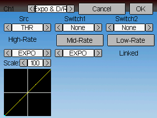

However I have a crash: if I go to the mixer page end change the channel to "Expo & D/R" type, the emulator craches and closes.
This was an uninitizlized value. It worked fine in linux, but not windows. Anyhow, it is fixed now.

Replied by FDR on topic Re: GUI
I've made some mistake: the lower two boxes on the main page are no longer in boxes, but I can't see anything...

18 Jul 2012 19:35 - 18 Jul 2012 19:40 #570 by FDR
FDR wrote: I've made some mistake: the lower two boxes on the main page are no longer in boxes, but I can't see anything...
Something is fishy in the ini parser...
I saw strange thing before too, but then I couldn't replicate, but now I can:
The timer boxes appeared if I pulled the font-timer section in the config.ini upper. If I put it before the throttle section, then the throttle boxes go wrong. If I have uppered more, everything seems allright...

18 Jul 2012 21:01 #572 by PhracturedBlue
ini parser should be fixed. There is a really hairy piece of code in there to support the devo file i/o and getting it right in all cases is quite tricky, there may still be other bugs like this lurking.
